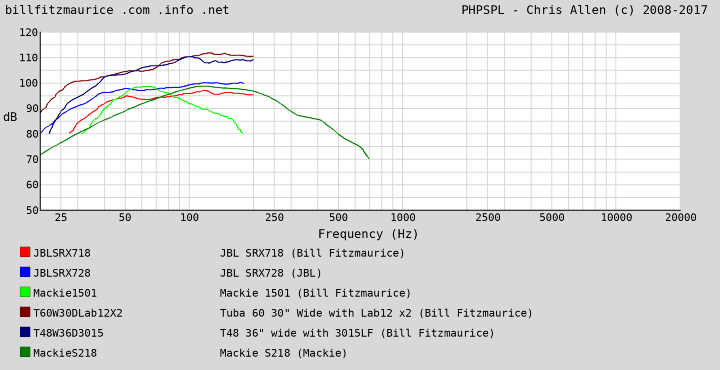

Re: Introducing SPL Chart

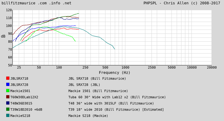

I just wanted to put together a frequency chart of the best of bfm subs compared to the other manufactured subs. I have a friend who has doubts that wanted to see them compared to jbl and mackie especially. All i have to say is

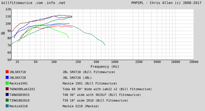

And I threw in a T39, 18" wide with an S2010. Don't forget, though, that the S2010 is limited to 28v (150w)
....and I wanted to highlight the estimated feature by adding +6 at the end of the T39 cab name

2x15? psh

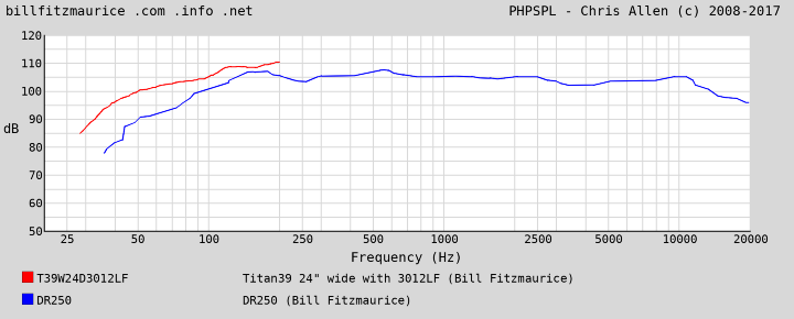

Can someone please post a chart for the 24" T39 LAB12 loaded cab front loaded version and the new version DR250 Delta Light II 2510 loaded in both melded and straight array?

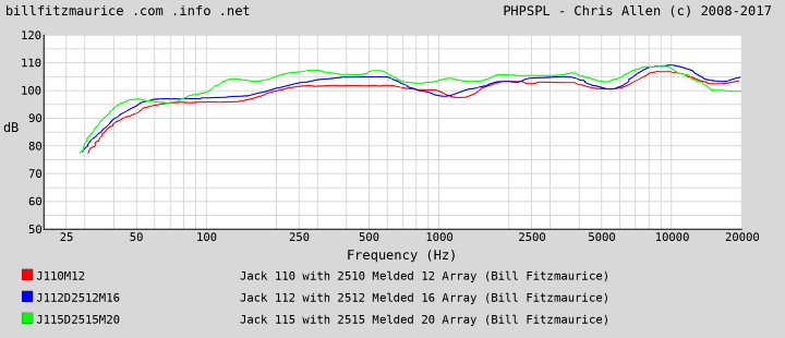

This has no relation to the above post - I've got a gig tomorrow where bass has to be backline, sold all my J112's and wanted to know of 3 J110s would be better than 1 J115 in case I need to crank it up.
Curious as to how you were planning on wiring up 3 cabs. Will your amp handle a 2.5 ohm load?
Close enough.
