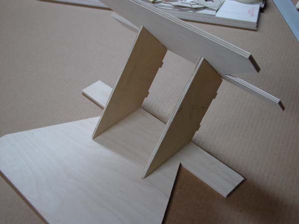

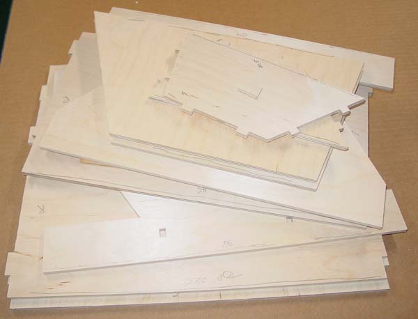

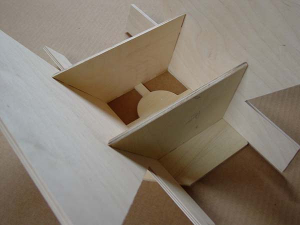

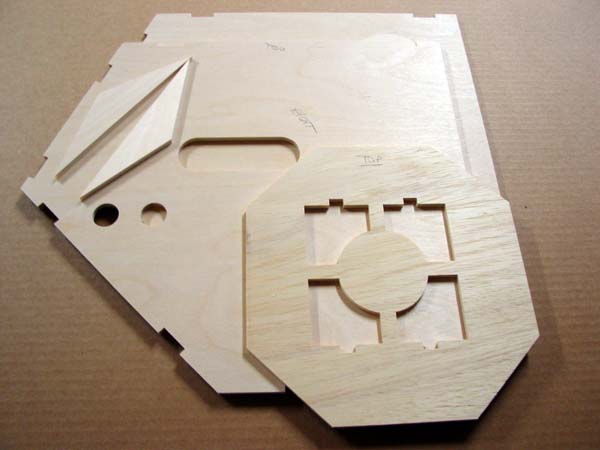

Finally got the W8 Lite parts cut out, since I need to do a rush build on this, and finish the J10's for next weekend. Similar construction to the J10 Lites.
Decided to cut the angles on the table saw to save time. Went through and marked what side to cut, which side of material gets cut off, and degrees very clearly. Reminder to self, get new blade

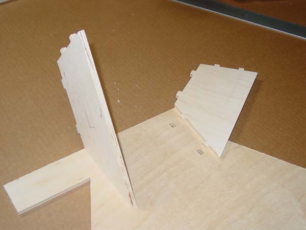

Here are a few pictures of the dry fit. Only found one cad mistake, made the top 1/4" too long, and to re-cut the angled side, now everything fits as expected.

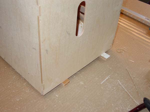

#2 Post by eac »
More pictures.....

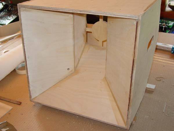

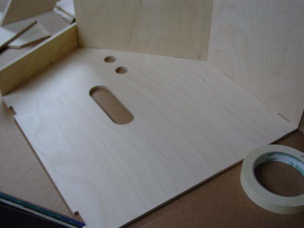

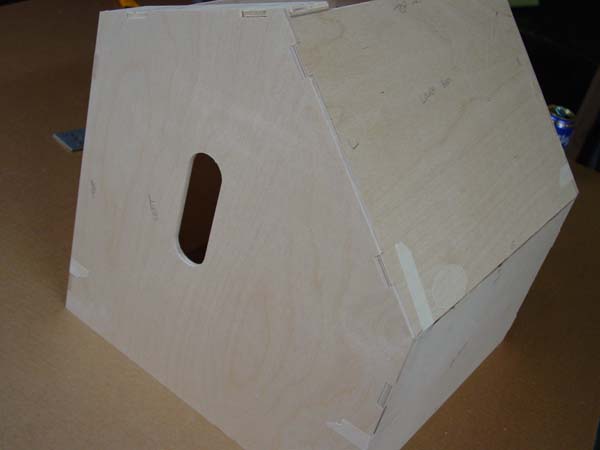

Finishing up and 1/2" W8 and a W8 lite today. Down to the wire on this one. Had to borrow a pair of Mackie 450's, since no way to get the Jacks and the monitors done in time. I used the Mackies last time we did this, and they worked fine. Just 3 folk/bluegrass bands in a small outdoor setting. Would have liked to have the Jacks ready, but this weekend.
Just a couple pics, didn't take many while in a rush to get these done.
First shows how to get the horn to line up with the cabinet. I placed a couple of 1/2" pieces, wider than the cabinet, under the sides of the horn section, so the not yet flat top and bottom fronts don't reach the table. Then the cabinet can slide right over the horn, also resting on the 1/2" pieces, making everything fit nicely, no fasteners needed at all. This may not make sense until you are building one, kind of hard to describe. Wish I had of thought of this for the 1/2" W8.
Be sure to reach inside and glue the top of the baffle and the side braces. Much easier to do when puting it together this way.
Oh yeah, the picture was taken after the fact. Be sure to cover the two 1/2" pieces with freezer paper, or whatever you use, so the 2 pieces don't stick to the W8
The other is the glued in horn section, with a little scraping done. Top and bottom fronts haven't been sanded flat yet. The hole is for the tweeter wire.
Will get finished pics up when done. Don't know if I'll pause for pictures. Just getting the gasket tape, xover coils, and corners later today. Why wait for the last minute?

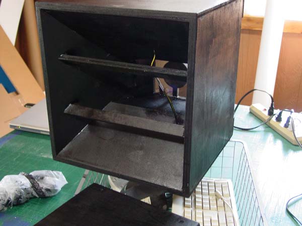

:oops: 2 Melded arrays built and wired. CHECK
Sanded and painted 1/2" W8. (1 side to go) CHECK
Isn't it amazing how painting the cab makes it look SO much better. :loler:
The tweeters look much better live, not sure what the flash did... :oops:
Only have to paint the other side panel, add the foam batting, the choke to the LP filter, and add the gasket tape and feet when they arrive, and install the speaker. Then button up the 1/2" W8, and do final leak test.

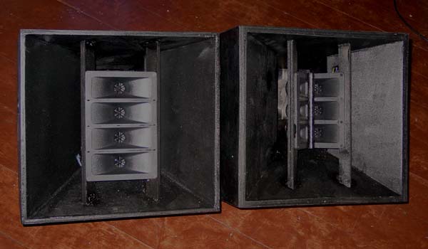

I put Top Hats in the Wedgehorn 8's, as shown in the picture. Did a bunch of measuring beforehand, to be sure there where no obstacles, of course ;) Drilled the holes, cleaned up the inside, put in extra batting, and installed the top hats. Put two rings of PL around the hole before installing, so no air leaks. After the screws were in and the PL cured, took out the screws and filled the holes with PL, and reinserted the screws. Been too busy to even put on the Duratex, but since they get used so rarely, black paint is fine.
I figured even if they didn't work for what I needed, having stand mount monitors may be useful anyway ....
The results were beyond my expectations. After some RTA time, a day before the expo, I fired them up with some music I was very familiar with (Early YES Albums), and walked around the pavilion. Except for some lacking bass end, which isn't needed for speakers only anyway, the sound coverage and consistency was the best we have ever had there! The shorter, and as I found out, very even throw from the pair of stand mounted W8's was perfect in the speaker area, with very little bleed into the vendor area. Even a lot of the attendees that have been there for the last 3 years even noticed the difference. Even coverage everywhere it needed to be, without anywhere too loud :) :)
