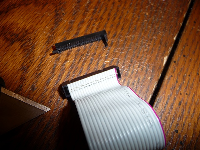

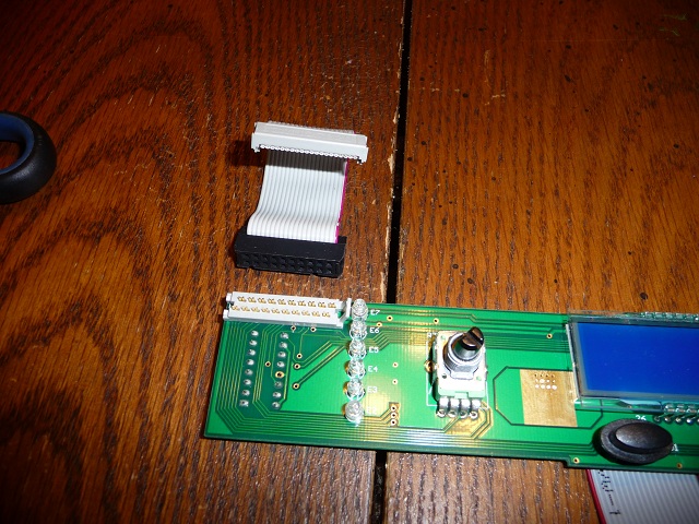

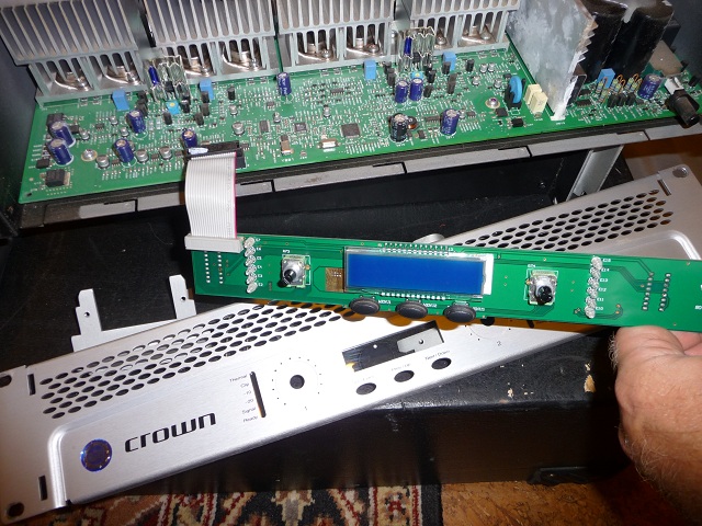

Remove the top, face plate, and attenuator nuts
The cable plugs into the main board. The display board end is not meant to be removable, just break the tabs off and remove the cable.
Remove the plug end from the cable also.

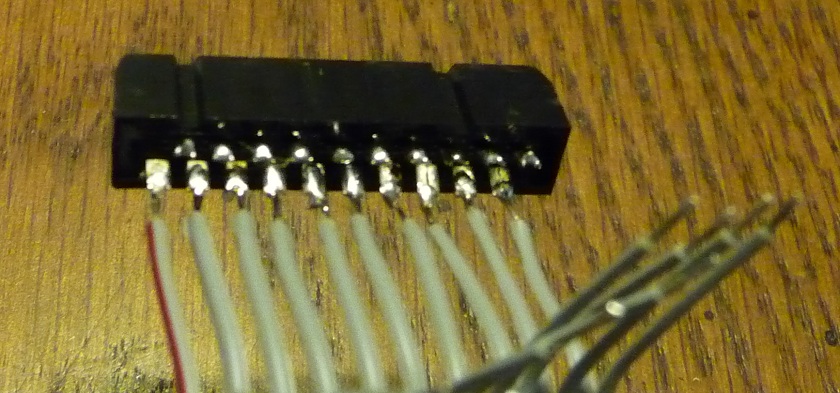

Bend the rows of contacts on the plug to form a "V", so you'll have more room to solder the wires.
Radio Shack ribbon cable. Stripped and tinned.

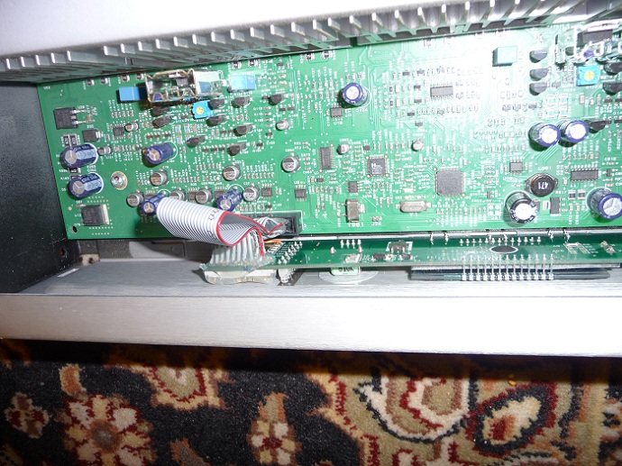

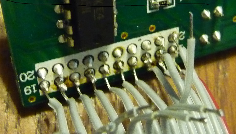

Solder plug.
Solder the display board.

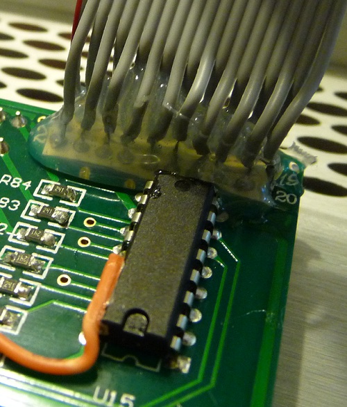

Apply hot melt glue to to the solder joints on the plug and display board.
Reassemble the amp. Note I also applied hot melt glue to the original contacts on the front of the display board so they weren't exposed.
The amps have had no further glitches. I have 40+ hours on them since the repair.

On the display board end, why didnt you just desolder the contact then solder the ribbon through the vacant holes?

Desoldering 20 pins and getting them all to let loose with out delaminating the traces didn't seem worth the time or risk of damage.colt45ws wrote:On the display board end, why didnt you just desolder the contact then solder the ribbon through the vacant holes?

I can see that. Figured there was a good reason.wallywally wrote:Desoldering 20 pins and getting them all to let loose with out delaminating the traces didn't seem worth the time or risk of damage.colt45ws wrote:On the display board end, why didnt you just desolder the contact then solder the ribbon through the vacant holes?
