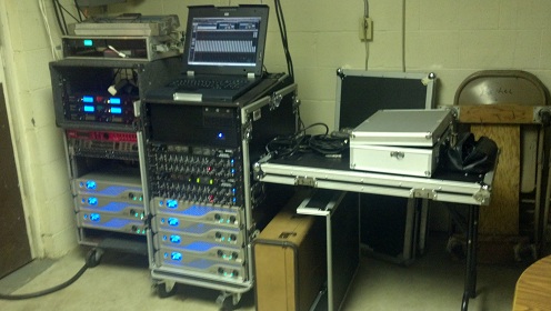

The DDT circuit in the IPR3000s is effectively a 59v limiter. I have 3 IPR3000s and 5 IPR1600s (one is missing in the pic)netwerks wrote: I wish that Peavey DSP IPR3000 had a better limiter in it!
I agree that the DSP in the IPR3000DSP is lacking, but given the price difference, you can pair the standard versions with an outboard processor and have a great system.
