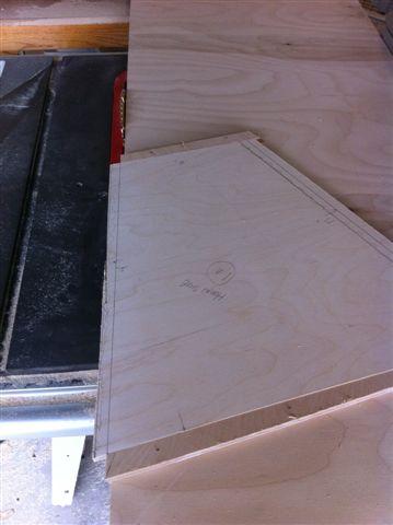

First, make sure that you draw your panels as mirror images. You need the cut lines to show.
Since the front and back of the Side Panels are parallel, go ahead and make these cuts.

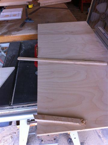

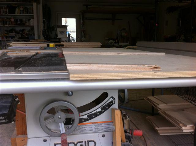

For the top and bottom of the side panels, use a piece of scrap plywood to serve as a sled. Set the blade to the proper angle. Line up your cut lines to the edge of the sled (you’ve already run this through the saw to make sure it is parallel to the fence). Take two scraps and tack them with a brad nailer snug up against the two edges with a half an inch or so hanging out over the edge.
Move the fence over a little and run the sled through the saw so that you just cut the protrusions. This cuts the protrusions to proper angle.
Now replace the panel and line it up to the edge of the protrusions. Make the same cut on all of the panels if you are building multiple cabs.

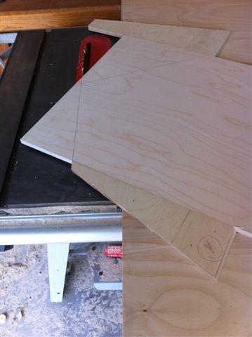

Now for the mirror image panels, start the process over and run all of them. Notice the different orientation of the stops.
Now use the same process for the other angle cut, doing first the 3 left panels, then resetting the sled and doing the right sides.

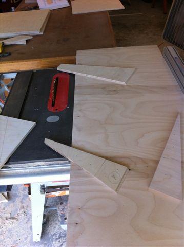

With a brad nailer and some scraps, this goes real quick. After three cuts, just pop ‘em off, chunk ‘em, and start with some new scraps. I used ¾” brads so they didn’t go in very far.
You can use this same process for the top and bottom panels too.
Here's what the side panels look like...

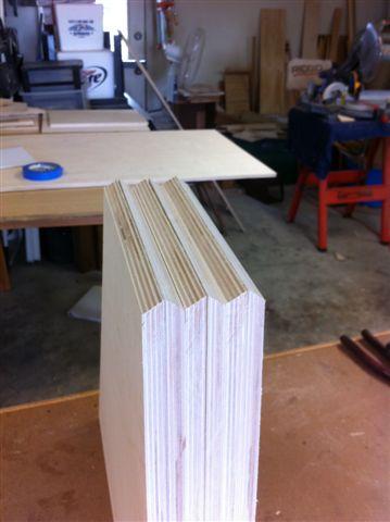

This same process works well for the side panels of the box. This way you get exactly the same cuts for all panels.....easier to square up that way
And what the hell.....it's a great way to turn scraps into perfect braces...
