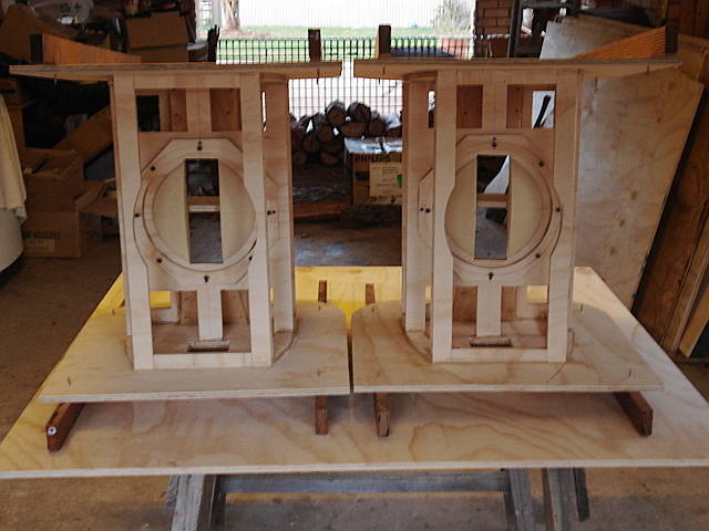

Day 6.
3 hours including cleanup time.
Started out cleaning up PL on the first cab.
Then cut more hardwood up to use as straighteners/dewarpers.
I bought a Merbau decking plank (heavy dark redwood hardwood) 90mm x 19mm (err not quite 4" x 3/4") when I started the T39 builds, specifically to cut up as dewarpers. Cut to length, slice down the middle to end up with 45ish x 19. I use them on their edges, clamp the ply and merbau together to pull the warp out, insert heavy screws, done.
I know it's not 2 x 2, but it does the job.
So, dewarped second cab and finished it to the same stage as the first cab:
Called it a day, haven't slept much after working last night and on again tonight... so chill time

Baltic birch users are some lucky fellows.
I had my pine ply go its own way after I cut it. I got the worst of it out by dampening it and laying it flat on the concrete with a big pail of water on top. It still took a lot of wrangling with clamps and logs to mate the horn panels on my little BAT.

Gregory East wrote:Baltic birch users are some lucky fellows.
I hear ya Gregory. :cussing:
It would cost me almost as much to get BB to me as it would to buy it!
And why would I bother when I found a nearby source of locally made radiata ply at $15/sheet.
Laughing all the way to the bank!
So far :fingers: my builds have been not overly bad with warping.
However, when you have to make critical measurements to cut more pieces to put into the build, as is the case with the DR's, I figured the extra half hour to sort it was well worthwhile...
