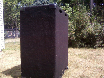

I purchased a second Titan to go with the one I built with a friend. I loved the price and skipping the build phase, but since it wasn't a visual match to my other, I knew some work needed to be done.
Here it is, fresh out of the van, with all manner of debris stuck to the felt-like carpet. Being an extraordinarily hot day (look at my yellow grass), I left it in the sun and then peeled the carpet off. Unfortunately the adhesive didn't want to let go. I scraped, sanded, rubbed it with soapy water, goo gone, adhesive remover and gasoline, but there was no magic bullet. Scraping was the most effective, but time consuming. Even after I scraped, fibers were still there and it was still sticky. So I painted it. It turned out okay. I saw where the spots needed wood filler, and the fibers that resisted scrapping stayed flat. The second picture has one side unscraped, one side scraped, and one scraped and painted.
I plan to Duratex it, so texture isn't going to be bad. Next step is sand, fill and sand. Then prime and Duratex.

After seeing that, it sure does give strong points to go straight away with Duratex. At my place of employ, I have to remove adhesive sometimes, and I don't like it. I have found that methanol, or rubbing alchohol works. I'll sort of work it in, and then use a scraper/ razor blade to scrape off. Rinse/repeat.

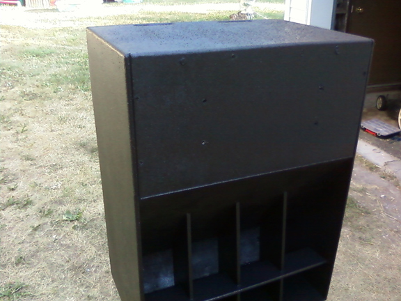

After more sanding and scraping, I used a ton of wood filler. Carpet covers up a lot. Then I sanded some more. This is a big box -- I used 3 cans of black spray paint to cover it. Hopefully I can Duratex it tomorrow or the next day. Here's hoping I have enough leftover. :fingers:
This Titan was made for the Lab12, and has the chamber reduction panel built in. I'm going to use a Kappalite 3012LF, so I need to open up the chamber. I charged up my old (really old) cordless drill, but it only lasted for two holes before dying. I was hoping to get my jigsaw in there, but it was too tight, and the drill holes were just a smidge too small. I'll have to try to borrow a dremel or something similar. I'm driving myself to finish it by Sunday, so I can use it at a gig where bass will be welcome.

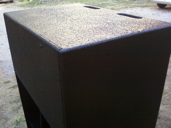

After 3 or 4 years, the Duratex I bought for my first T39 is still good. I added water, and it acted a little funny, but after a little time getting the textured roller rolling, it started to look right. It would bead up, then the roller would seem dry, then suddenly it would start flicking all over my hand and shoes. Oh well, it works amazing in the end. I love Duratex. This gallon has now covered two T39 and two DR200s. Even with my same old 99 cent brush, it looks and covers great.

I noticed it on the first round of pics and now on the finished pics: The line I see where the side meets the top, is that a gap or just not well sanded panels? Of course if its a gap, re-glue it and check for air leaks there. If it's just a not quite finished corner - who cares, run it!
edit: Duh, that's the access panel! Never mind, never mind, never mind. Sorry about that - I haven't built a t39 yet so assumed the worst. Go about your business.

This T39 was made right after the price skyrocketed on the 3012LF, and so the design was adapted for the Lab12. I'm assuming that piano hinges turned out to be a weakness in the design and so they were removed from the modern ones. Also, the reduction panel cutoff the bottom of the chamber, instead of vertically like the new ones. My favorite part is the corner, where the lid fits between the sides. Finished Duratexing the bottom tonight. Tomorrow I'll assemble the rest and test it out. I'll still have to open up that reduction chamber somehow.
