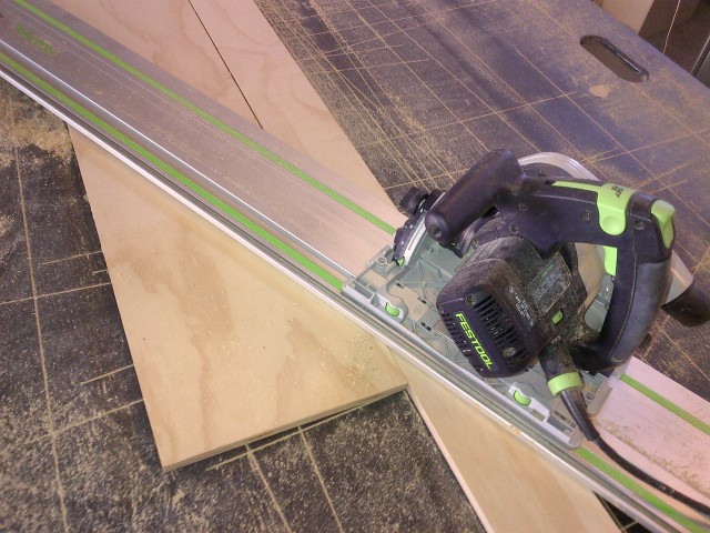

LelandCrooks wrote:I can see that kind of cut. I think my choice of parts was poor. I'm thinking parts like the 4x5 supports behind the throat in a Jack or an omnitop. Non rectangular small pieces.
Hate to resurrect this thread but here is a picture that depicts how you do it with the Festool, Leland.
It does not matter how big or small the piece you need, all you need is equivalent sized board underneath the track system to support it. I ripped 8' x 1" pieces for a few hours on Sunday.

#43 Post by LelandCrooks »
If I only had traditional table saws I can see the utility. One of my saws is a sliding table with a larger miter guage, which it appears to me accomplishes the same thing.
I still may have to get one someday.
