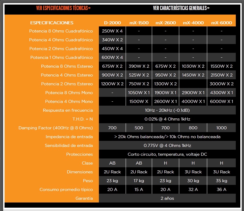

here are specs of the bunker power amps
and the comparison of the bfd-o and bfd-1 vs other loudspeaker processors
