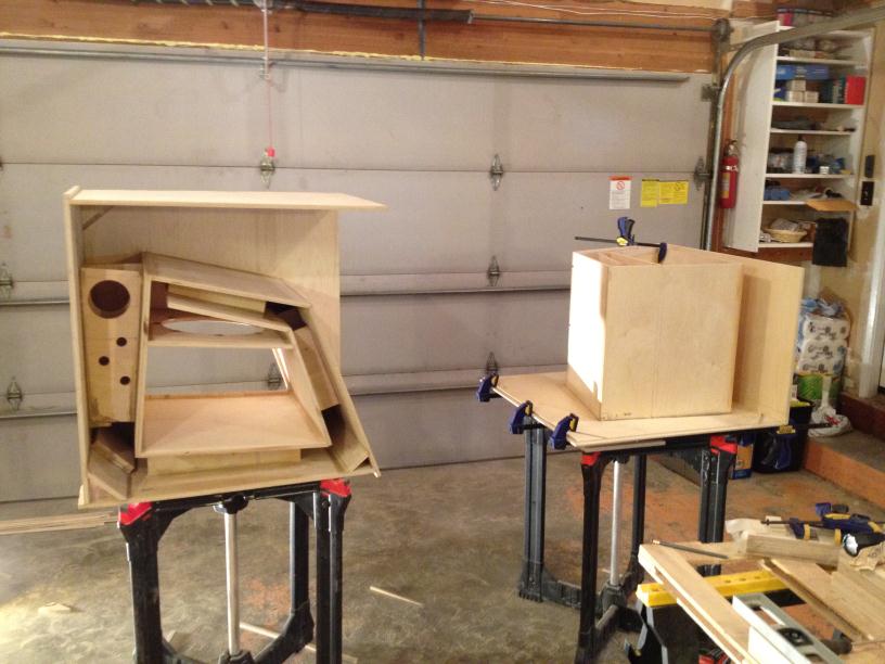

Day 10
Not much done today.. got the braces installed in sub 1, and an update on sub 2.
Almost there...

Day 11/12
A milestone today:
FINALLY.  One side panel on.
Spent a little while filling holes, test-fitting the driver, and preliminary leak-testing. All clear, except of course the gaping hole in the side of the box where the access panel will go. Also some minor leaks around the gasket, but that's to be expected since I didn't tighten it down. (I'm a little nervous about spinning a huricane nut. I did use epoxy though...)

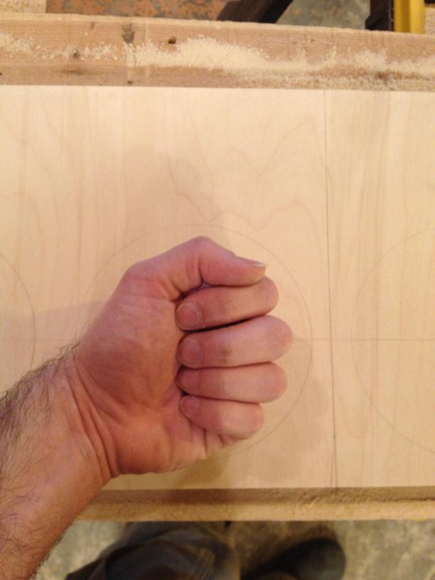

Speaking of which, it's well past time to get started on those. It hadn't really sunk in how small these drivers actually are. Here's the pattern, with my big fat hand in front of it.
I thought it would be bigger...

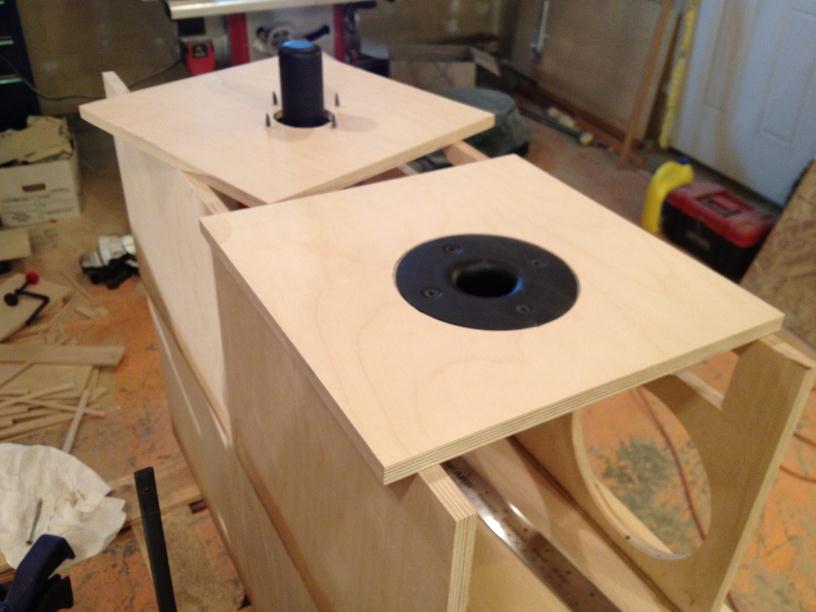

Day 14
Two days until showtime.
Got the tophat flush-mounts done.
The one luxury I made time for.

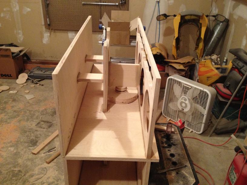

Braces cut and installed:
These things practically build themselves.
If you've built a set of these, this may look a little larger than you remember... Well, they are. I lengthened the front-to-back dimension enough to add a plate amp. It became clear early on that designing the PCBs, ordering the parts, assembling the electronics, having the plate CNC'd, etc., etc., was not going to happen in time, so they will be passive for now. As such, they will likely get an uncerimonious 1/4" hole for the wire to poke through instead of a proper Speakon plate (though I ordered some, just in case.)

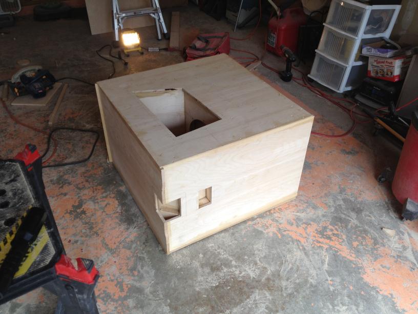

Back to the subs...
So much more complete with that side panel on.
1/10 braces installed, panels 11 and 13 installed, and finally, some access cover flanges installed. Those were done throughout the day, due to limited number of clamps -- and space to fit them in.

Question from a novice woodworker, what do you use to flush mount the top hats?
Put rubber feet on the bottom for storage and you don't need to flush mount it.
Otherwise, rout it out.....

Yep. Measured the diameter very carefully and made a circle jig for the router, with a measured plunge depth pre-set. I then re-used the 2-1/4" hole saw from the tweeter cutouts for the "tube" of the hat.
