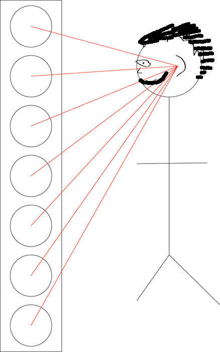

Bill Fitzmaurice wrote: And being a line source you can't get an accurate measurement unless the mic is at least four times the array height distant. preferably more.
How does that affect listening distance?
Your ears aren't as fussy as a microphone, so even twice the array height away is fine.

#42 Post by GirlyHandedDog »
I would guess this has something to do with it:
subharmonic
Posts: 2061
Location: Mandan ND
Re: a pair of TLAHs (rectangular)
#43 Post by subharmonic »
Thanks Bill.
GHD you have some mad drawing skills. Maybe a bigger smile and the hair being blown back more would have been more descriptive.

GirlyHandedDog
Posts: 186
Joined: Tue Mar 02, 2010 7:59 pm
Location: Lehi, UT
#44 Post by GirlyHandedDog »
subharmonic wrote:Thanks Bill.
Yes, I know. Please do not print this out and hang it on your wall without my consent. Thanks.
