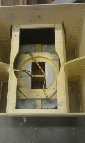

So, now the woodworking is done, atleast for now, started to put in dampening material and drivers today. The plans say I should put foam dampening in the driverchamber, and polyfill around the throathorn, I´ve done that, but after that the plans are a bit unclear, it says to put foam on the backpanel of the piezo-modules, on the woofer side, but it doesnt mention anything about what to do when you have the compressiondriver module, which doesnt have a closed back, because of the CD´s themselves. So the outside of the compressionhorn and the inside of the whole module is a part of the driver chamber.
I´m really unsure if I should put foam everywhere in the module or not..
I would really appriciate an answer on this, preferably fast, they are gonna play on friday :P I know I shouldnt rush them, but it should be alright, and I dont really have any choice..
In the picture I attached you can see how I´ve put dampening foam in them now, is this enough, or should I cover the small exposed parts of the baffle also? And yeah, how about the HF module?:)
Handles and a proper grill, and proper paintjob om the HF horn and well, the whole cab, is gonna have to wait till after this rental on friday, l´ll paint them black tomorrow and put on a simple foam front for now..

Either foam or poly is OK in the module. 100% coverage isn't necessary.

Thanks för a very fast reply Bill! I´ll try a bit tomorrow, see which is easiest.
Other than that it looks ok? I´m guessing there´s no need to cover the baffle also?
