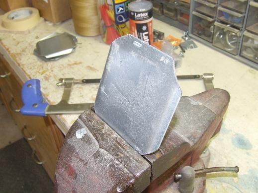

I didn't want to drill holes in my new T-39s, so came up with a clamp system that is pure DIY. The idea is to use compression to hold the v-plate in place. I've been using it this way for two years now and it works fine....with no holes in the subs.
The apparatus is built using square, flat electrical box covers welded to bolts (or attached with epoxy).
First, cut the corners off the box covers with a hack saw...
Then, "curl" the edges so that it can easily slide across the mouth of the sub from any direction....
Drill a hole in the center to accept a bolt. I had my neighbor weld them for me, but epoxy would work, or you could use threaded rod instead of a bolt and put a nut on each side....

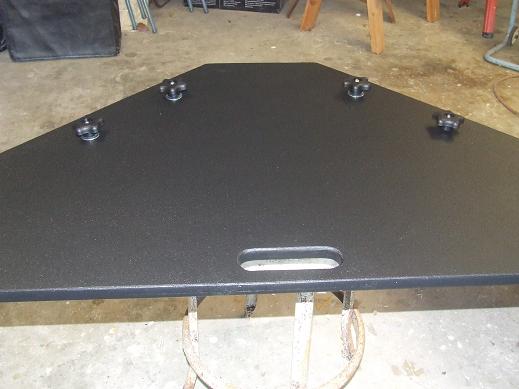

Build the V-plate as in the plans. I affixed guide blocks so that alignment was perfect every time. Drill the holes for the clamps....
Buy some star knobs....but, don't get them in the fastener section of your HD or Lowes...get them from the lawnmower section. About 75% cheaper for the same thing.
Put in the plates and screw on the knobs..
This is how it attaches to the subs looking from the bottom. Loosen the knobs so that it will slide easily onto the subs until it hits the guide blocks, then crank 'em down.
I also added weatherstripping along the edge to keep it from slipping and rattling.....
These have worked flawlessly. You do have to reach in to hold the clamp from spinning until it's tight enough to grab hold. But then, just crank it down tight. I've never had it come loose and since it's self-aligning I don't have to hunt for the holes to connect it like you do if you just drill holes in the sub.
