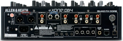

My DJ mixer is an Allen & Heath DB4. I want to run a monitor (booth) mix (on DB4 on TRS jacks - see pic - sorry it's a bit small) to WH10s. Can I / should I run straight into amp and to wedgehorns without DSP?
The main mix is on balanced XLRs to Itechs. The Itechs' DSP - esp limiters - is partly what attracted me to these amps.

The DCX unit has 3inputs, and 6 outs, all capable o being independent, so you could use a pair for FOH and the third as a monitor processor.
You could have the chain thus-
for FOH - stereo out mixer into DEQ- DEQ stereo into DCXinputs 1&2- out to mono sub, plus L+R mains.
For mons- mixerboothout - straight into input 3 of DCX - out one of the remaining outputs. (the DCX has enough parametric eq to process monitors I reckon. Hipass, tone control etc)
that leaves you still with 2 of the DCX outs to use for delay stacks, full range side fills, whatever. :)

Dave Non-Zero wrote:The DCX unit has 3inputs, and 6 outs, all capable o being independent, so you could use a pair for FOH and the third as a monitor processor.
Thanks, Dave. Yer a star! :clap:
