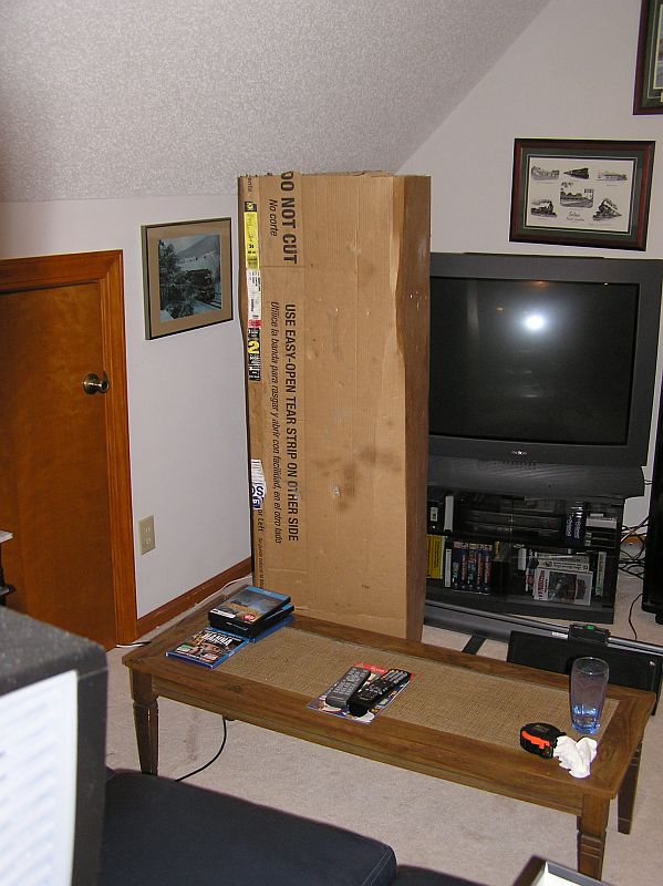

Before I got that phone call, my friend and I were trying to measure out where I wanted to put the new TTLS. We had to move that old ProScan CRT (37" I believe) and I was using my tape measure to see if we had room. It looked way too close for my comfort level, so we mocked up the TTLS with some 2X2's and carboard and I have to admit, it is a LOT bigger than I saw in my mind's eye.
We moved things around and I hope this placement won't be too bad. It is out from the wall the correct amount, but kind of crowded at the mouth with the angled wall. I hope it is OK. What do you all think?
The wall is a 45 degree angle and the 18" side is facing forward (towards the rear of the tower speaker).

How does it look? It looks like you may have to learn to love the new 'floor mounting' of those pictures once you get this finished!

I always love that moment. It has happened to me on each build but the second T39.NCDaveD wrote:I have to admit, it is a LOT bigger than I saw in my mind's eye.

Take into account the magnet next to an older TV like that.
