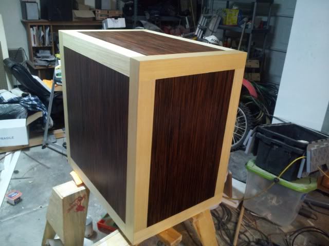

67baja
Posts: 931
Location: Las Vegas, NV
Re: Finishing a Tuba
#5 Post by 67baja »
67baja
Posts: 931
#6 Post by 67baja »
My cabinet was newly built out of 1/2" Baltic Birch. I had never applied veneer before doing the THT in the pic above. It was tedious and very time consuming, but not difficult and I the think the end result is worth the effort. The way I veneered: use a paint roller to roll on yellow wood glue on the paper side of the veneer and also onto the baltic birch cabinet. Allow the glue to skin, then place the veneer on the baltic birch. You can move the veneer around to get it where you want it. Then iron it with a regular old household iron on high heat setting. Iron from the middle of the veneer outward. The iron drys/melts the glue and kind of squeegees the air out too. Trim the edges, sand, then apply your favorite finish. The cabinet I did was only done a few weeks ago so I cannot attest to it's long term durability. Also, if I would have used only one kind of veneer, it would have been WAY faster. It is a royal pain to do 2 kinds of veneer and make the edges/seams fit nice.
