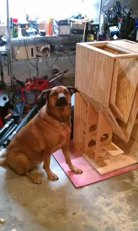

Got the plans. Couldn't find the 5 ply Baltic birch around here, so I got some wood that didn't look too bad with as few voids as possible. Figured out I'd mess something up anyway on the first one, so no big loss. Build was easier than I thought, with a few jigs and some patience. Drilled shallow reliefs for the T-nuts on the speaker ring. Sealed them up with silicone.
About to seal it up and paint. Asked my kids for a Gallon of Duratex for Christmas. this winter I'll build 1, possibly three more.
Can't wait to hear it.

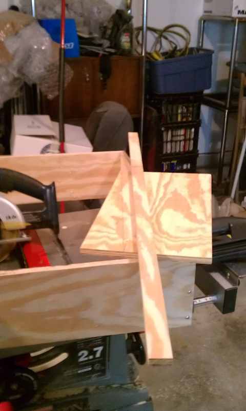

Built a little 16x16x5 inch box frame to set work on. leaves enough room for saw blades underneath. Tack a couple of brads through the work into the box and things stay put for making those odd cuts.

You dog looks kinda pissed. Is he a camera shy?
