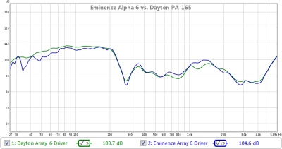

Wasn't sure where to post this, so I'm putting it here. We've had some discussions about the usability of the Dayton PA-165 in the SLA Pro and the W6. I had the opportunity to measure a group of cabinets that have both drivers. These cabs are similar to SLA Pro (not identical, as driver count, tweeter type, dimensions and porting are different). There were 12 dayton loaded cabs, and 4 eminence loaded cabs, these are the averages of those measurements. There was remarkably little variance from cab to cab. The cabs are biamped, and the test was calibrated to 1w/1m, measured at 10m.
There is remarkably little difference between the Dayton and the Eminence drivers... 4-5db in the 1-4k range, and a bit smoother through the middle, but that difference gets EQd out, realistically... and in an A/B comparison, the difference was inaudible even with no EQ applied.
The chart is band limited to the woofer response.
Dayton PA165 vs Eminience Alpha 6

- eminence alpha 6 vs dayton pa-165.jpg (25.7 KiB) Viewed 2186 times

But that's a 6 up against an 8... the Alpha 8s have far more capacity.gdougherty wrote:Unless something changed with the design in a big way, my original Dayton loaded w6's were very poor compared even to my Alpha loaded W8's. The Delta Pro does it even better.

Either way it comes out close on price, so it came down to driver performance. So I looked at the spec sheets of the Alphas -- 3.5mm Xmax. And the Daytons.... don't say? I checked the PE woofer selection guide and it listed 0.5mm.
I'm not even sure whether to accept that as fit for woofer duty.
I put the two speakers' specs into WinISD and modeled a vented box with equivalent internal volume and vent size. I added a 2nd-order LR highpass @ 100Hz.
On the Dayton, I hit peak excursion at about 5 watts.......
I think it was somewhere around 150Hz, but it's been a week or two. I have it saved, so I could check.
The Alpha could go upwards of 100W, IIRC.
This is assuming I did the modeling correctly, and the Xmax really is 0.5mm... Enclosures aren't my strong suit, so salt is a serving suggestion.

I can tell you that we measured at 100w/10m... which is far more than .5mm on the Dayton. The 0.5mm xmax is simply a bad measurement on their part. I would be suprised if the real value is very close to the eminence.

All of them that I have are in cabinets. I can tell you that I handled a dayton and eminence in my hands at the same time last week and they are nearly identical. The Eminence has a slightly different cone structure, but without the stickers, the motor assembly couldn't be told apart. The Dayton actually feels better built. Xmax really isn't a quantity in midrange usage anyway, becasue you typically run out of power handling first.SirNickity wrote: Seeing as how you obviously have the physical driver, do you have any documentation that shows the real Xmax? I think I'm resigned to biting the bullet and paying for the known quantity (Alpha), but it would be nice to see the capabilities anyway..
If they're the SAME PRICE... get the Eminence, as it has a slight advantage in the critical 1-4k voice range... but this isn't anything that can't be fixed with a smidge of EQ.
HOWEVER... considering the Daytons are below $20 in quantity... they sound and perform virtually the same. The colleague whose cabinets I measured runs 12 out of his 14 cabinets with the Daytons. An event story for you: he sometimes calls me in when he needs to do long distance delay stacks so I can just handle it for him while he does other things. With his two systems set up, (they're basically identical, the big system has 4 top cabs per side, the small system has 3), we threw sound up and down a mile of downtown at an event where there were over 1000 motorcycles on the road.
In other words... the Daytons are a far better value. I put them in the SLA Pros I put in my church... they don't disappoint. There is no audible distortion at any volume. In my colleague's rig... they do high volume rock shows without breaking a sweat. This is a great little driver for SLA type designs, no questions about it.
