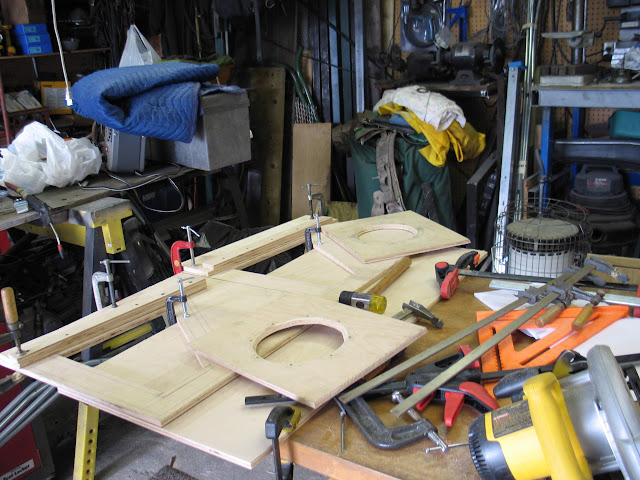

Laying out the panels
Laid out ready for Panel 1 which is the baffle for the TAT. We got them cut and started figuring out how to make the circle hole but I had to split.

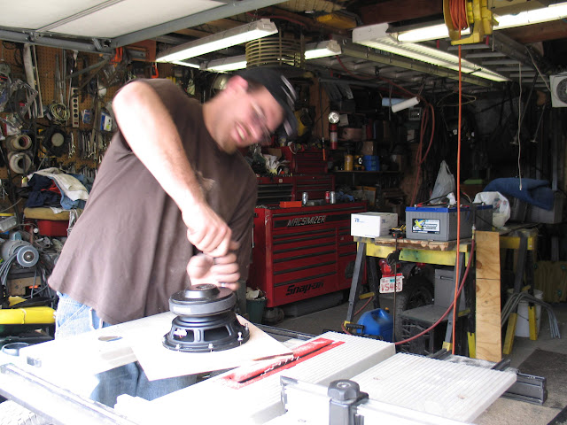

Cutting speaker hole in the baffle.
Test fitting drivers for the "rub test" 20hz @ 8v

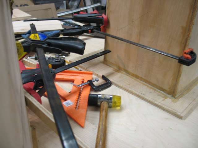

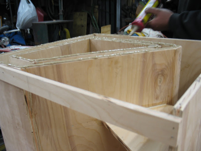

(finally) first bead of PL
Naughty and Nice
Angle of the camera makes them look crooked (I hope)

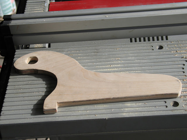

Last project of the day...a plywood pusher for the table saw.

I hope you had some nonstick wrap on the guide board when you fixed that first panel on or you may have trouble removing it after the glue dries!

did not do that w/the guide boards. Guess we'll see what happens once the clamps come off.
We're being careful to no over do it on the PL...

LEVLHED wrote:did not do that w/the guide boards. Guess we'll see what happens once the clamps come off.
The clamps will come off....
The guide board? ....not so much....

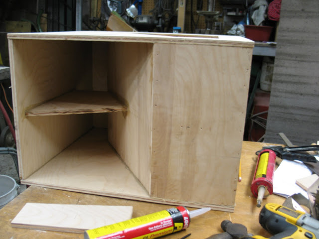

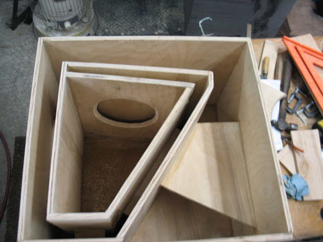

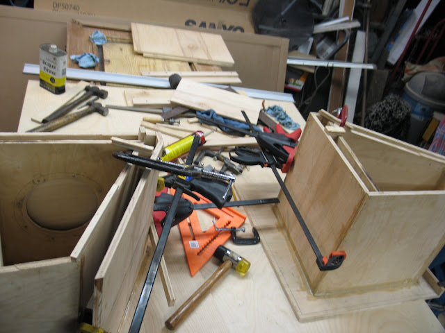

Got them built this last weekend except for the recessed access covers. Just plain ran out of time. We're going to rock out the cheater covers until we have time to come up with something else....
I spent some time this week w/ 60 grit and a random orbit sander to at least shore up the edges. Larry works for an industrial painting company and has access to sprayers and left-over industrial paint. Still waiting for a report on the available colors. No clue when we're going to get them finished up yet, we're both super busy for awhile now.
Next step (tonight?) is to bolt in a driver and see what happens.
Not as comprehensive in documenting this time....too busy trying to get the darn things built in the time we had.
