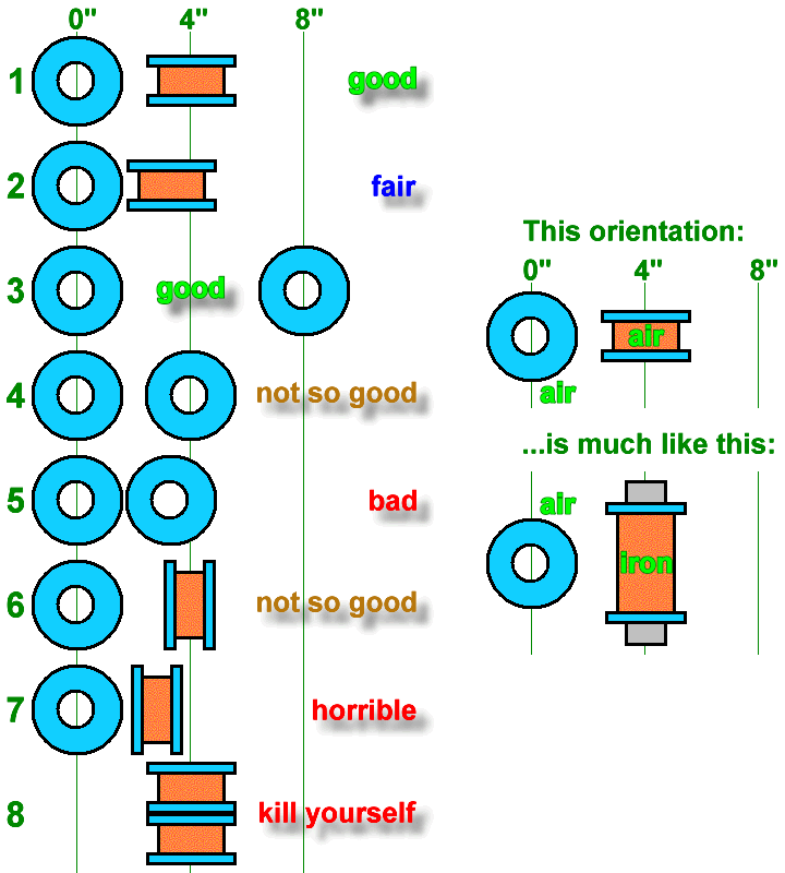

You're going to do them on 3 different boards, right?
Coils must face different planes and directions, the further apart the better.

I removed and reassembled the high-pass filter off the board, with the coils as far apart as the leads allowed from the board and each other, with their axes perpendicular and not pointing towards each other or in the path of the coils still on the board. I checked the wiring before, during, and after assembly for accuracy. Still no change in the performance.
I have a wedding tomorrow night where I have to use this cab, so I removed the tweeter components and rewired the midrange components accordingly... assuming it makes any difference at all with my mess of a setup.
Next week I'm going to try a ground-up rewire, with all wires, coils, everything as isolated as possible, and if that doesn't make a difference I'm probably going to say screw it and order a complete premade crossover from Leland. I've wasted enough time and energy with this, I'm done dealing with it.
