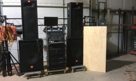

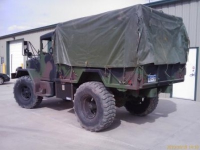

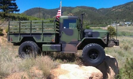

Hey guys my name is James and I live in Monument Colorado. Started building car audio sub boxes in 1987 then I moved into home theater systems and doing the DJ thing since about 1997. My DJ rig now is JBL 18in subs powered by a Crown xls-5000. 2 x JBL dual 15in cabs on top powered by 2 x QSC usa900’s. I also have a DBX Drive Rack PA+. It’s ok for most indoor gigs but in a warehouse or outdoors it is severely lacking. The outdoor parties have become my favorite thing to do. We 4 wheel to a remote spot and set up for an overnight party with up to 400 folks. We play all kinds of music. I personally love the deep bass so I have started my first set of 27in wide tuba 60’s with the LAB 15in to replace my JBL 18’s. Ok guys so here is my idea. I have a custom built 4x4 Military truck. I want to build the bed into a rolling sound system. The truck bed sits about 3.8ft off the ground and is 9.2ft long x 6.3ft wide. I can set two tuba 60’s side by side between the wheel wells with the mouths facing out the tailgate towards the crowd and place 2 more on top of them. I have no walls to “load” them against as we are out in a field or on top of a mountain. As I understand it the tuba 60’s also do not benefit from a V plate either, so will this sound OK or am I missing a better way? My amps and rack will be setup behind the subs also in the truck bed. I am thinking of building dr250’s as my tops and they can be hung from the side rails of the truck at about 7ft above the ground on either side. My goal is to just back up, take the cover off the truck bed and be operating in no time. I can easily load/unload the equipment into the truck at my shop with the forklift but prefer to keep it in the truck at the gig so it could be covered quickly for rain, keeps it up and out of the dirt, away from the drunk folks, and almost no on site setup. What do you think?

This is my old system.  The marked up Tuba 60 side panel is shown for size comparison.
This is the Truck.
This is the Truck.
Cover installed
Cover installed
