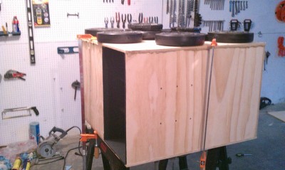

I just put the side on my Tuba HT yesterday (around two weeks after I ordered the plans)! This is the first enclosure I've ever built, so it definitely is not perfect and putting the side on was one the worst part of the whole build (just knowing that there is a chance that the PL may not sealed a section). I started out wanting to build a sealed box, then decided on a ported box, and then found Myn's thread and ordered the plans as soon as I finished reading his thread.
Today I took off all of the clamps and the couple hundred pounds of weights I had on top of it (letting it cure for about 30 hours) and now I'm trying to decide on the best way to finish it. I am thinking of sanding it, followed by black latex, and then finishing it off with duratex paint. But I was wanting to ask if there is another textured paint that is recommended instead of duratex? I'm willing to buy duratex, just would prefer something that I could buy locally. But if I'm better off with duratex, then I'll definitely go ahead and order it.

  Here is a few pictures if anyone is interested:

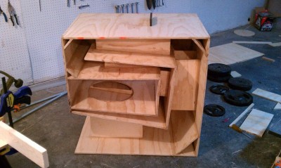

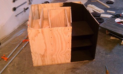

 I messed up and was about to ask what impact it would have on the over all sound of the Tuba HT.  Looking to see if some one had already asked this, I happened to see the picture of this build and he did the same thing and I doubt he even realized that he messed up as well.  You can see, on the last picture, that this baffle is turned around 180 degrees.  So the question is; what impact will having the baffle turned around 180 degrees so that the driver is closer to the front of the enclosure, by about 5", then what the plans call for?
