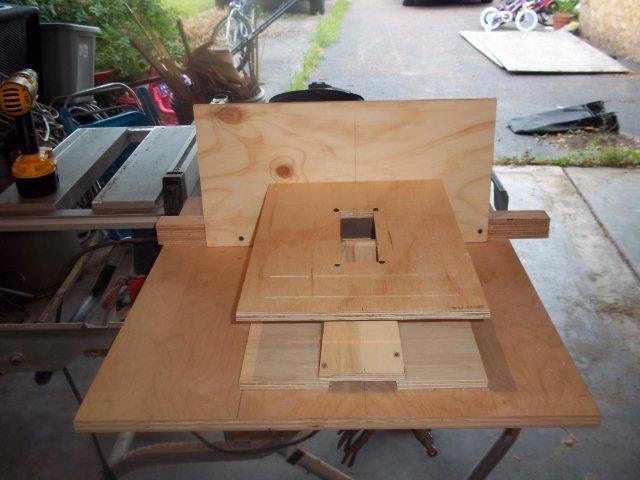

The picture below shows two of four sled type jigs I made.
Sorry I have not been good at documenting each piece as I cut it. (I tend to get real focused when I work on these type of projects.) The jig on the saw is the 7 degree thoat horn jig. The other, standing against the fence is a peizo cutting jig.
The pic above shows a better end view of the sleds. I used 3/4 scrap that I had. One 3/8 strip was cut to go underneath in the track. I used a 1 1/2 inch piece screwed to the outer edge as a secondary guide.

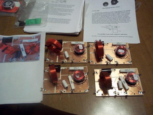

Again, it was too hot to go to the shop, so I started working on the crossovers.
I bought the boards from Leland. I think it really makes it easy to get the parts in the right place. Well worth the money IMHO.
