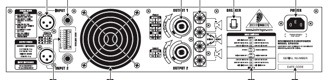

Does the back of your EP4000 look like this? Is so, then ditch the RCA-XLR patch and use a RCA-1/4" TRS patch instead (unless you're certain pins 1 & 3 are bridged together). Take advantage of the unbalanced input instead of attenuating what little signal makes it out of the Onkyo (The impedances are different). Set Mode Switches 1&3 to OFF. Crank the knobs wide open on the EP, then trim the receiver accordingly (like -13 dB or whatever it ends up during setup) lest you'd like to continue listening to an overdriven signal.
