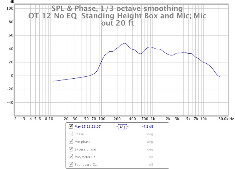

OK...I just took this with the Behringer ECM800 measurement mic going flat into my board, from there via USB to RoomEQ Wizard, set to RTA 1/12 octave, sending full range pink noise with no EQ to the Otops only. I meant to post as 1/12 octave but had trouble bringing that version back. Do those setting sound right and does the chart look reasonable?
Thanks!
Donny
UPDATE: This is not right...checking again...
Thanks!
Donny

Re: EQ Question: Are My Ears "Messed Up"
This is the corrected take. The previous one was using the wrong mic. How does this look?
Looks close. Reduce the range so you can see vertically better... You want to be able to resolve 3db or less

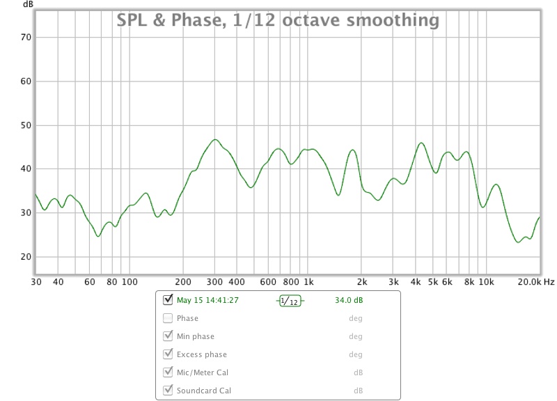

Here's another one...not sure this is what I should be getting...BrentEvans wrote:Looks close. Reduce the range so you can see vertically better... You want to be able to resolve 3db or less
That's OK, but smooth to 1/6 octave, that's the industry standard as you can't hear 1/12 octave anyway. To see where to set your EQ use 1/3 octave with a 31 band, 1/2 octave with a 15 band.doncolga wrote:
This is another test of one OT12 with pink and sine sweeps. The last measurements inadvertently had the crossover settings on...don't know if that makes any difference or not...
Does is matter which one I use? I guess the pink noise I could run constant and adjust the EQ until its flat?
I tested my commercial top and it wasn't as flat as the spec's say, but I'm sure I'm not using exactly the same procedures either. It was interesting to compare the two.
I notice the db's on my charts are alot lower than other's I've seen. Are those others pretty much blasting? I didn't want to drive my neighbors nuts today...even though we are out in the country...
Unless you calibrate with an SPL meter, don't worry about the levels that are reported. You're not measuring sensitivity anyway, you're measuring response.doncolga wrote:I notice the db's on my charts are alot lower than other's I've seen. Are those others pretty much blasting? I didn't want to drive my neighbors nuts today...even though we are out in the country...
