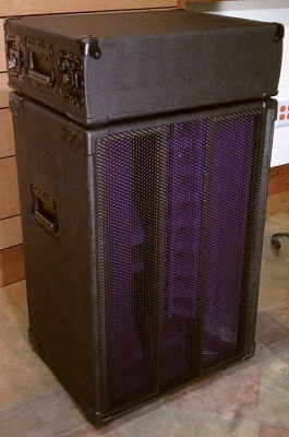

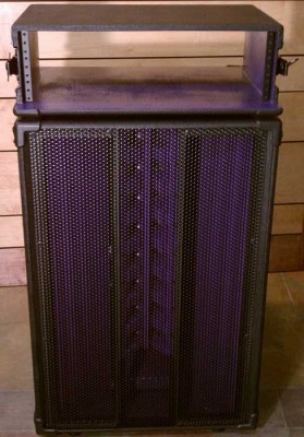

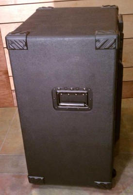

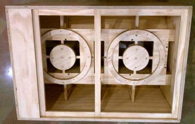

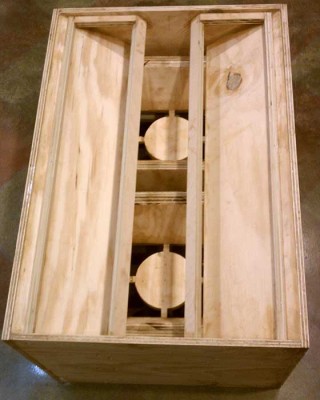

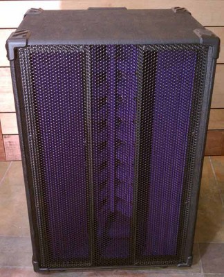

After I managed to blow the speakers in my SWR Super Redhead for the second time I decided to build a Jack 210. I used Arauco plywood from Lowes, Deltalite II 2510 speakers, and 16 1016 piezos. I wired the piezo array with a on/half on/off switch. I went back and forth on making it and "Airhead" but ended up making a separate matching 3 space rack. I routed holes for the handles and butterfly clips. It has tilt back casters and a extendable handle. I painted the inside of the cabinet and the rack purple and the rest is painted with 3 coats of Duratex. Took me about 3 weeks to build.
The rack will be loaded with a Genz-Benz Streamliner 600 (as soon a I get the rack kit), a wireless and compressor. I only recently bought the SL600 and am still getting use to it.
I was playing for the musical Footloose all last week and used a Stingray 5, SL600 and a Carvin 210 for most of the shows. I manged to get the Jack done in time to use it for the last two shows. I was very impressed with the sound.
When I was using my Redhead I cut my lows and boosted the mids a bit. The SL600 is very bassy and a bit mid shy. With the Carvin I need to cut the lows and boost the mids a fair amount but with the Jack I can leave the eq fairly flat. So far I think the Jack sounds great. My volume seems to be very consistent over all my strings. In the past I have had to cut my lows to avoid over powering my high strings and to cut through. With the Jack I am finding I can have a lot of low end with out loosing clarity.
I haven't had a chance to use it much yet. I play in a wedding band and a funk band and I have a lot of gigs coming up so I will report back after I have a little more experience with it. So far I'm loving it.

That is a fabulous looking cab. Is the handle once extended a little too high?
How does it compare weight wise?

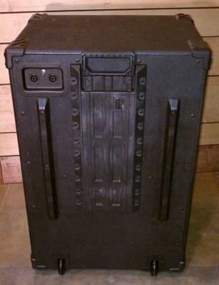

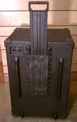

No it's the perfect height for me. It also locks in place when extended or retracted. I bought it from TCH http://www.tchweb.com/tchstore/product/ ... Black.html
I haven't had a chance to weigh it yet but I think it is a bit lighter that my Redhead.

Wow, man, awesome build. I'm working on a Jack 212. I'm going to throw the wheels on the bottom like you did.
Can you show some photos of how you have it wired up inside? I'm throwing 8 piezos in mine, so I'm thinking that your wiring will be similar to how mine should end up looking. I'm just nervous about screwing it up and wouldn't mind a few reference picks to have next to my plans when I start on it.

The tilt back caster idea came from "NoGraveConcern" on Talkbass http://www.talkbass.com/forum/f15/jack- ... ld-670856/
He recommended not using the casters he used but recommended using these http://www.reliablehardware.com/cornercastertilt.aspx as they are easier to seal and make air tight. I used the non corner version and some caulk to make them air tight. With the tilt casters you will need to add about 5" to the bottom of the back to attach the casters to. It makes attaching the speaker a little harder but not to bad. NoGraveConcern also gave me the following advice which I followed.
"Also, be aware that the tilt castors have a 90 degree bend and not a 1/2" radius like the other hardware. I just stopped my router short of where the castor would be so that it made a gradual transition in the edge of the wood from 1/2 radius to 90 degree."
For the wiring I don't have any pictures handy but I used the diagram Harley posted here for the DPDT switch. http://billfitzmaurice.info/forum/viewt ... DT#p150624
For the crossover I bought the following from speakerhardware.com “2k Piezo Array High Pass Filter”, “Low Pass Filter 2k 4ohm 500 watt”, and “2 way Circuit Board”. Used 20 gage wire on the piezos and 14 gage on everything else.
