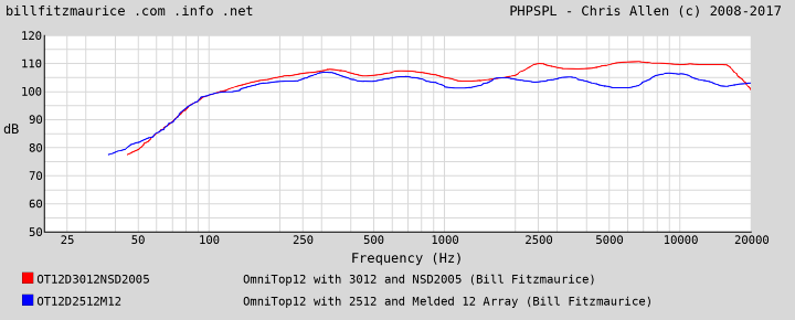

I still haven't had a chance to use the setup thingy on my Driverack PA to flatten out my Otop 212's w/ 3012's @ melded arrays. I was wondering if anyone else out there has done a EQ program to flatten the cab that they could share? I'm looking to set up the post EQ to try and get it as flat as possible with that. Then use the Wizard if/when possible to work on the room EQ.

Is this chart 3012HOs?

Those charts are were replaced. These are the new ones with the new baffle (with the phase plug in the center). Posted both since you are piezos but are using the 3012ho.

Is the chart I posted with the 3012HO or not?
Mine are the older style, not the phase plug baffle thingy. Is there a significant difference in freq response?
I can see now that there is a very significant difference between this and the previous chart, not nearly as flat so I understand how it would be difficult to work with the PEQ to flatten that.
I'm also not liking the really big difference in the 200 and down curve between the two charts. That's not at all what I expected after asking about this two months ago http://billfitzmaurice.info/forum/viewt ... =3&t=13558
Looks like I need to EQ down to under 100dB in order to get flat to 100hz which is where I currently cross to the subs.

mine are 2x12's, not 1x12's so I assume the graphs posted are wrong anyway.

I posted the charts with the 2512 and the 3012; they are labeled as such. The reason I did was because the 3012 is paired with the nsd which you are not running. And yes, these are indeed single otops, not duals. For duals, just flatten out the curve a bit more and raise the low end a little more than you would raise the high end. (around 500hz, of course, only one or two db's anyway). These charts have been up since the new phase plug design came out. However, they were first posted in the spl thread and chris later added them to the spl tool which might be the reason the new graphs were never posted in your thread when you asked.
PS. The new design didn't change much save for the phase plug which really only matters in the upper range of the cab(around 1-2Khz), so I would still try the eq with the new curves.

can anybody tell me which drivers are represented in the graph I posted?

2512

LEVLHED wrote: I can see now that there is a very significant difference between this and the previous chart, not nearly as flat so I understand how it would be difficult to work with the PEQ to flatten that.
Bill stated in another thread that the reason the charts for the phase plug baffle are different is because he was able to improve the accuracy of his measurement technique around that time if I recall correctly, not because the response is more ragged than the non-phase plug baffle.
