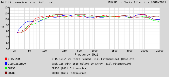

I have been torn between building an Otop 15 or a Jack 12 for my lightweight DJ rig. The Otop 15's seem to have more punch above 60 HZ than the Jack if used stand alone. None of this matters if you add Titan 48's to the equation. But I might have to make a decision based on what my amps can push.

DR280s? overall better sensitivity curve than the Otop15 but a bit bigger. a crown xti 200 would be prettty nice for them I assume.
