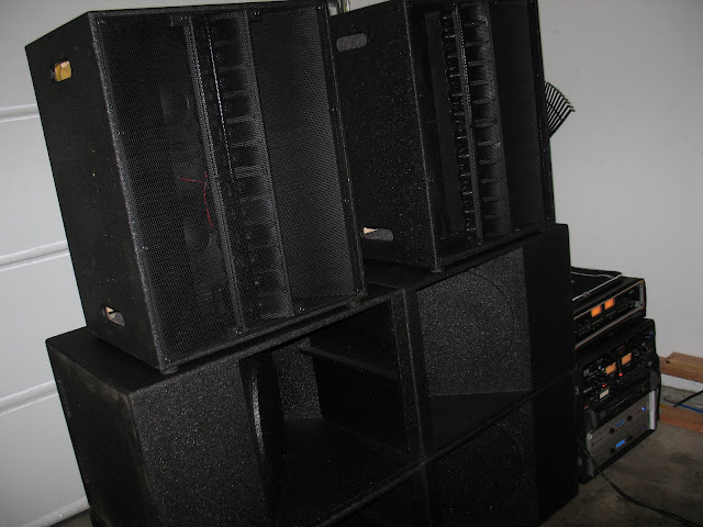

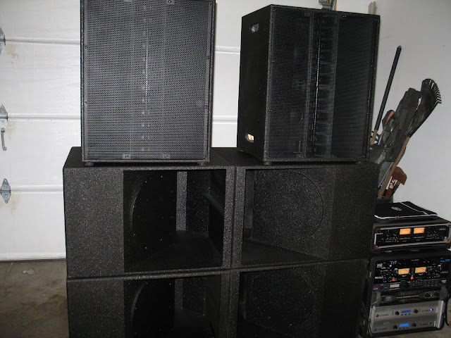

I took delivery of Mark's demo 212 Omni Tops today. I had him drop in the 3012s and install the melded arrays. He spent some time shoring things up both structurally and electrically too because we knew I was going to be driving them with max power (only when called for of course!)
Naturally, I needed to test them out ASAP.....so I fired up the whole system in my garage tonight.
Holy crap.
I'm looking forward to getting them EQ'd (DRPA) as I could tell there were some things going on...but it's also hard to pin point details @ war volume in a 2 car garage:) So the EQ was flat. HP the OTops @ 106hz. Some peaks and valleys, but nothing that totally jumped out enough to be really annoying. I could sense they were there. I didn't bother farting around with it tonight.
A friend happened to stop by and he got to listen. He commented on how clear it sounded, though to be fair he is generally easily impressed:)
I found it really interesting how they sound. It sounded great and really clear. The first impression though is that the highs are not loud enough, yet they were loud and plainly there. I guess it's just the difference in what I'm used to hearing w/compression drivers? I'm looking forward to hearing the arrays in a proper space so I can see what is going on with that. It's like I'm used to hearing a shout, but now it's a many really loud whispers...or something like that. (I've been using little JBL MPro MP410's...which are now for sale)
So now I'm rolling with 2 x 212 Otops driven by a QSC PLX3402 (1100 watts a side @ 4 ohm) and 4 x JTR Growlers driven by 2 QSC XTi4000.
(OTops will go up on stands)
First gig will be a little get together day after Christmas in Milwaukee at a several-thousand square foot loft. I'll post more after that.

Weird, is the left box taller than the right?
Did you listen to them side by each, or, one atop the other? If they were side by each you may have experienced some phasing.

I see how it looks weird in the picture, but trust me the OTops are the same size! I was just at an angle I guess.
The Growlers have some serious growl. They are the 2010 drivers. Efficient like a horn should be, good to about 40hz, relatively flat curve. And yes, small. Pack space was a real concern so that's the way I went because I wanted to fit 4.
But this thread isn't supposed to be about Growlers. There are threads on other message boards about them ;)
I set them up just to get a little instant gratification and verify they survived the journey. One of the diffusers popped loose so I just need to get that affixed. It wasn't meant to be a serious evaluation at this point because a 2 car garage isn't really an appropriate space for that kind of business!

Concerning the perceived lack of highs, the arrays have a near-field effect in the upper frequencies - that is, instead of the SPL dropping 6db at 2x distance it only drops 3db. Also, the vertical dispersion is decreased significantly which is a good thing.
IME, comp horns in typical cabs can cut your head off up close. The arrays seem to have a more even sound throughout the room.
When I first fired these up, they were sitting on top of T48's in a living room. We were sitting on a couch a few feet away, and there seemed to be a lack of highs. Then we stood up - big difference, it's very noticeable when you drop below the dispersion angle.
