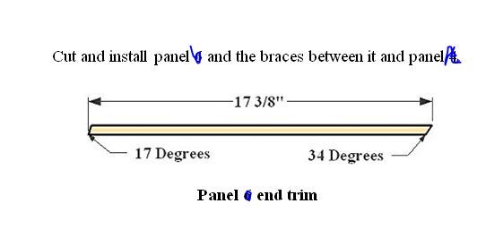

Just wondering how much "edge" is needed?
If using 1/2" baltic would 1/4" or half of the panel be considered good enough?
I am also wondering how I would set up this cut.
My saw is a festool track saw. I am thinking of setting my guiderail to overlap the panel, and set the saw depth so that the blade will cut the bottom half of the panel.
Not sure if this makes sense.
Some of the angles are 2, and 5 degrees so I may even just sand those ones.

I am not refering to a bevel at both ends.
I am refering to the "edge" of one of the ends.
Plans say to bevel the front or rear edge.
bean438
Posts: 232
Joined: Mon Aug 23, 2010 6:52 pm
Location: Winnipeg, Manitoba
Re: Front edge/rear edge tht cuts Festool track saw users pl
#6 Post by bean438 »
For example THT panel 4:
one end is cut flat, and the other is at a 3 degree bevel, BUT only the "upper edge".
Another panel has a 5 degree bevel "lower edge"
But while looking at the sketchup all the bevel cuts appear to be a complete bevel all the way through the panels, not on an upper or lower edge any ways.
Maybe a 3 degree becel or a 5 doesnt show up in sketchup as they are really small bevels?

bean438 wrote:Maybe a 3 degree becel or a 5 doesnt show up in sketchup as they are really small bevels?
Yes.
I didnt even bother cutting them on my first build but on subsequent builds I did. I think he is using the word "bevel" but it truly is a 3 or 5 degree miter cut.
