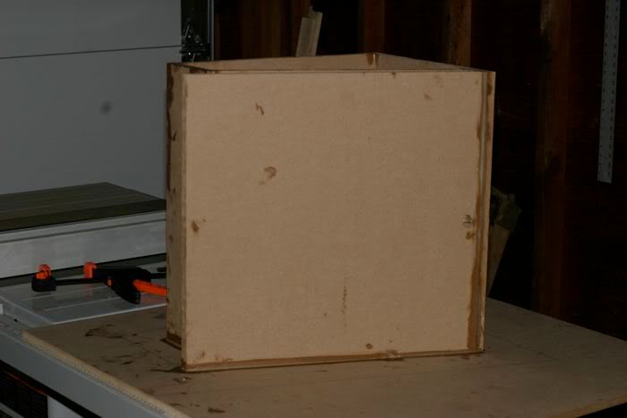

Ahh! Panel 5! If it's like the THT, that was also my panel from hell. The angle makes it so hard to line up with panel 1. Patience is required here.

Lol, yeah, it was a pain.

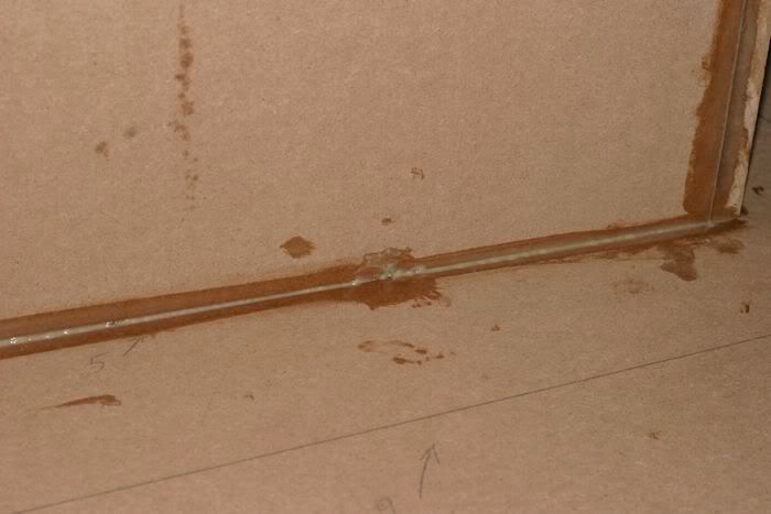

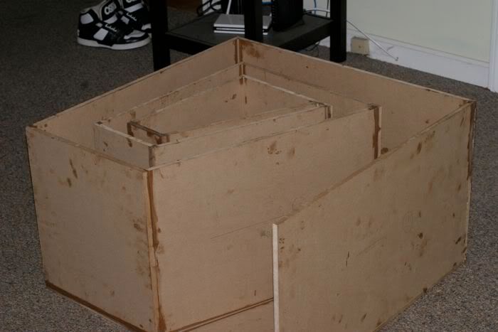

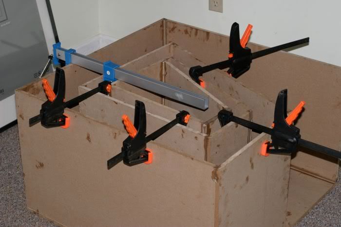

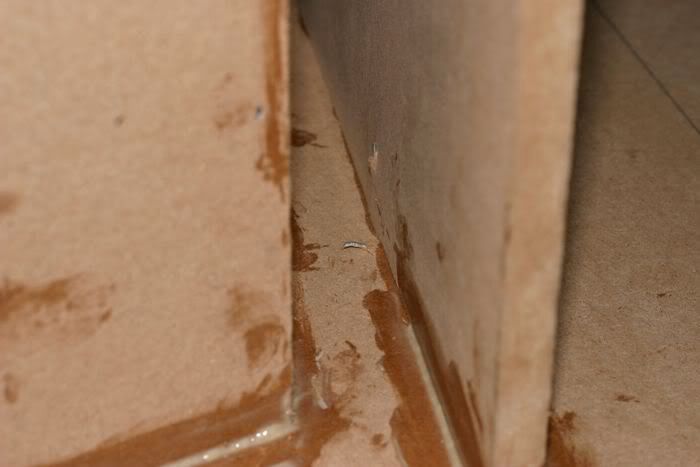

Here is my progress from last night, the hour and a half panel... LOTS of brads through the sides. Well, about 3 or 4 but still annoying...
Brad...
Brad...
Brad(ssss)...

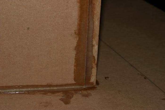

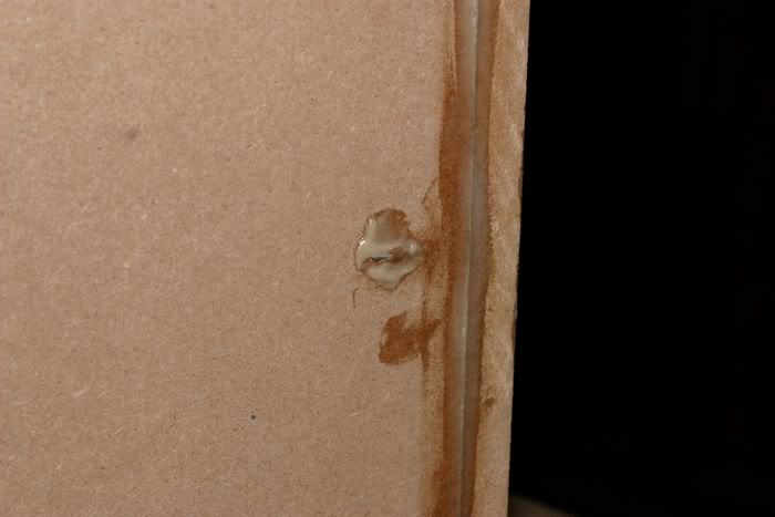

Here is where some PL started separating, not sure if it's separating from the seam or just a layer of PL separating from the bottom layer, hmmm...
Next stop, 3/5 brace.... TBC

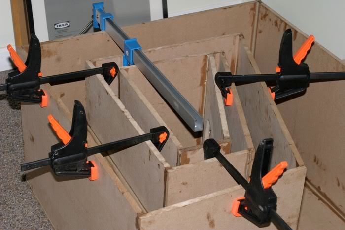

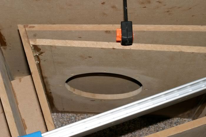

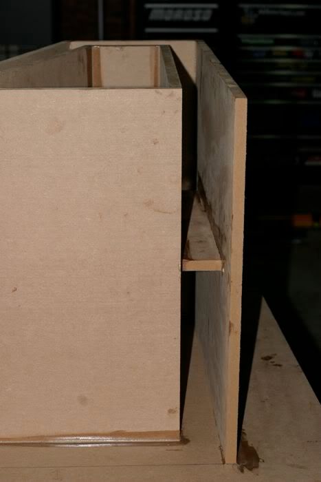

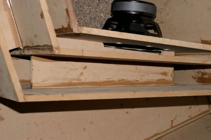

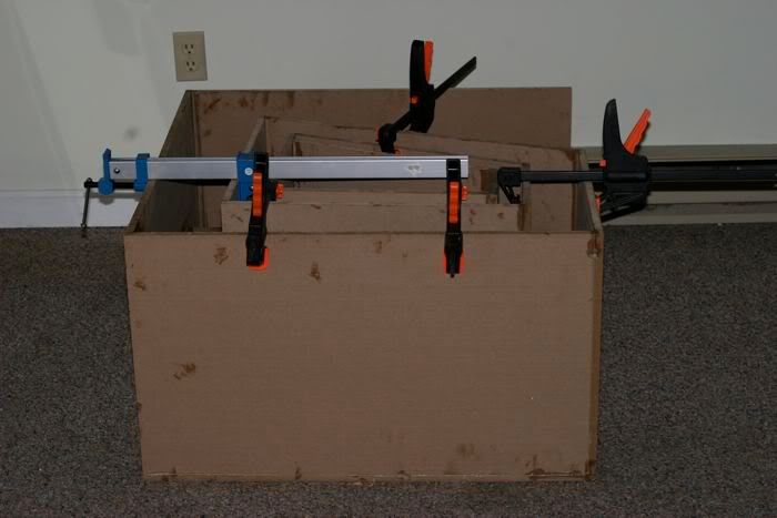

Here are a few snaps from the other night. I got the 3/5 brace, panel 7 and 1/7 brace installed. They went pretty smooth except for cutting the notch in the 3/5 brace
Otherwise I'm pretty happy and can't wait to continue

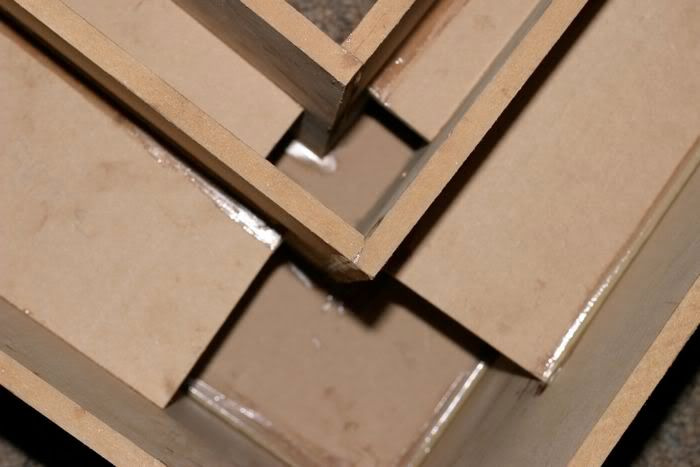

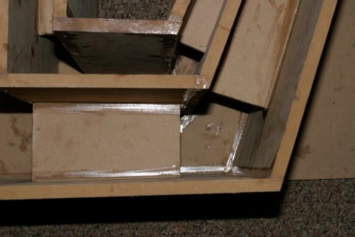

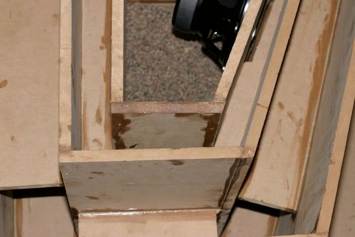

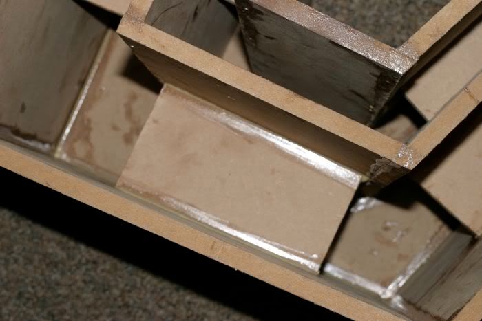

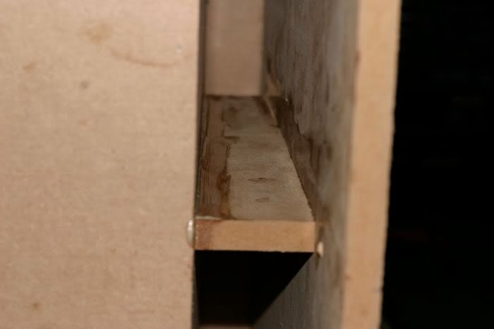

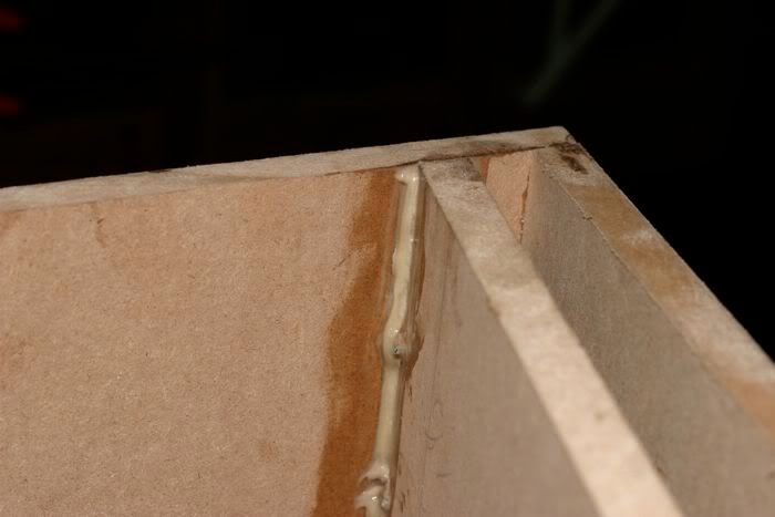

Now, here are some shots of the braces. Because it was tricky cutting them on the table saw and some of them weren't the snuggest fit before gluing and nailing, I was wondering if you think they will hold up. I hear the PL is very strong stuff so I probably shouldn't worry but take a look at mine and let me know what you think. I was only able to nail on one side which is why I'm not sure about their longevity...
After half way through the build, it started to go pretty smooth so I was excited to keep working on it, lol. Definitely, if I do this again which I know I will, I will go with at least plywood (probably baltic birch) for any units after this. I will also pre-drill, pre-fit and pre-assemble before applying any PL, then go back and assemble with glue and be done
Last part is the final side and front brace!
Re: Table Tuba build!!
I wouldn't sweat the brads only being on one side at all, the PL holds better than any nail could ever hope to. Braces look good - thumbs up.

Looks like I'm all set to continue. The PL really holds that good? The MDF would probably crumble before the PL lets go is what you're saying?

Try glueing some scrap wood together. Let it cure, they try to get it apart. My THT fell off a sawhorse during repositioning. It ripped a hole in the plywood and broke the sawhorse. The glue was still in tact.digital_chris wrote:The PL really holds that good? The MDF would probably crumble before the PL lets go is what you're saying?

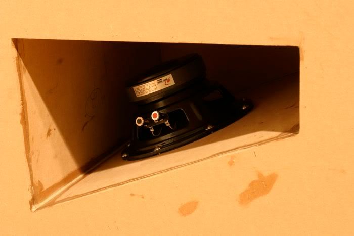

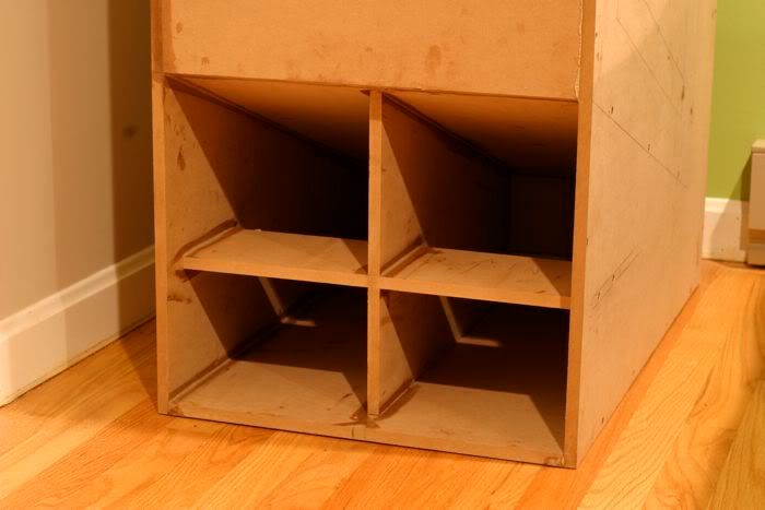

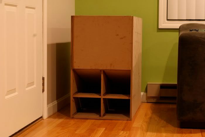

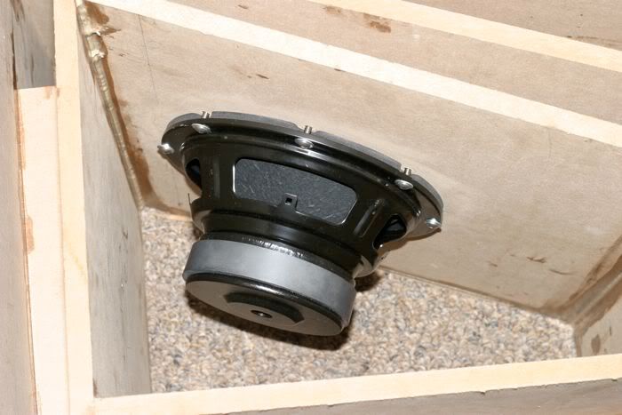

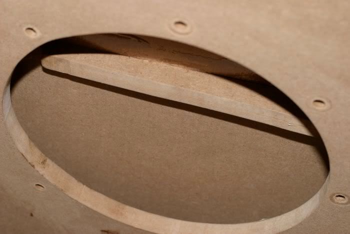

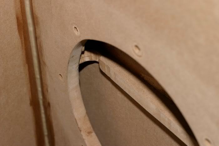

Well, finally finished!!! Check out the pics...
There's not much to look at, lol but there she is
I ended up using my cheapo Pyramid PA amp so I can get some tones through it. Ran a 30hz tone for a few minutes up to 7-8 volts and I can't hear any leaks, doesn't mean there isn't any :p
I also had the box sort of in the middle of the room but when sitting on the couch, the 30hz tone sounded well for 7 volts, what do you think this cab/driver is capable of safely hitting for voltage? The excursion was very small at that voltage as well, which gives me hope
Also, one thing I wasn't too satisfied with was when playing music tracks, there just wasn't really any bass...
I ordered a Foster plate amp in the mean time because I think that my Pyramid just plain sucks, gain was turned up almost all the way to get 8 volts
That's it for now, feel free to post comments
