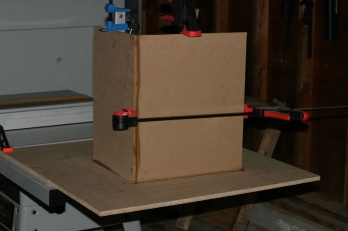

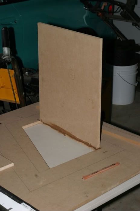

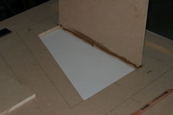

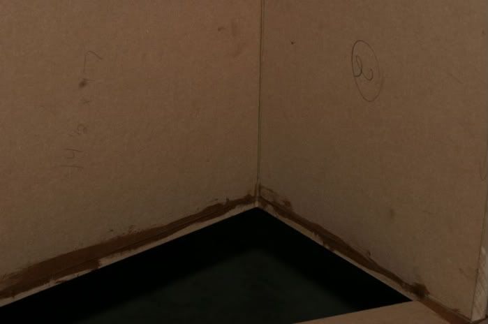

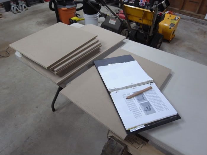

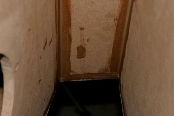

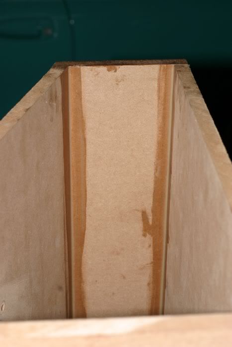

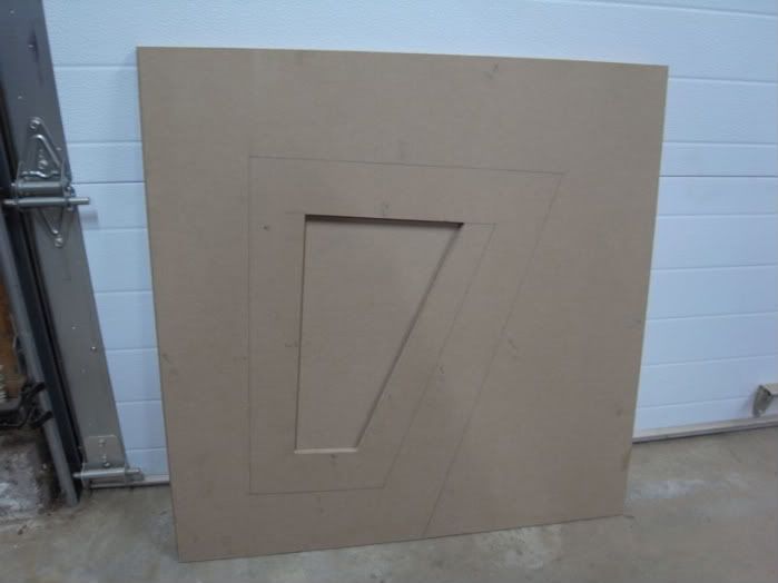

Hey guys! Well, I finally got around to start gluing my box together, had the pieces cut for a few weeks now but this week I had some time to start assembling her.
Here are few pics of my progress so far, and to any of you that have built any of Bill's units, please let me know if you have any suggestions for me :)
I don't know how heavy some of you have gone on the PL or if I should leave the "extra" on the parts or smear them smooth like I have so far. Any suggestions would be great :)

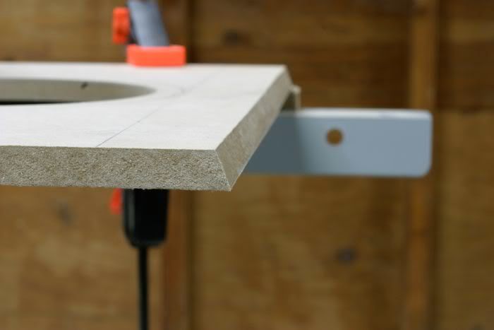

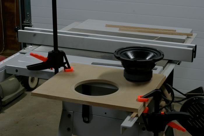

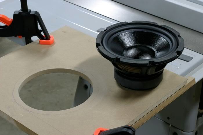

And here is the drive hole cutout with the driver next to it...
I am especially happy with the angles in the instructions, my table saw is cutting them to a T! I am pretty pleased with how this is coming together so far :)

When it's complete, you'll have to report back whether the cab vibrates any at full tilt with the MDF and all.
How well does the PL seem to work on it?
Careful when drilling around the baffle for the driver mounting screws, don't want that stuff to crumble out on ya.
Other than that, looks like fun! :clap: It's going to get heavy in a hurry! :wink:

Happy building!
About the PL, just let it squeeze out along the panel edge and harden (don't need to remove or spread). On the exterior you can use a chisel or flush bit to remove once it's hardened.

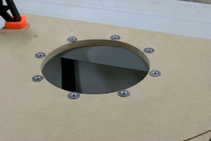

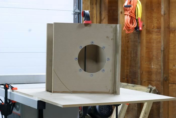

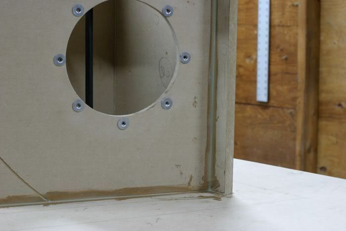

MDF does ok for house stuff, but that's about it, but as it is a TT, no worries there. HOWEVER, if it was me, I would either 1) use tnut/hurricane nuts or 2) attach the driver on a spacer made of hardwood and glue that to the mdf. My mdf would want to crumble whenever I was building the thing and I just wouldn't trust it at all with the single 1/2" to hold the driver with wood screws.

How about constructing a ring made of plywood, glue it on the opposite side to the driver and install T-nuts into that plywood?

Then it'll mess up the horn dimension. If using t nuts no need for the ring. The ring is really if he's just going to go with wood screws.

Reread my post, if using the hurricane nuts and he's careful, the mdf will be fine. My recommendation on the ring was if he was going with wood screws (for the driver).

It is actually the Dayton DCS205-4, the alternative to the MCM because the MCM was not going to be available for a while. I'm not too worried about the MDF though, the hurricane nuts I will be using will be close to the edge of the baffle hole but I shouldn't have to much of a problem with it :)

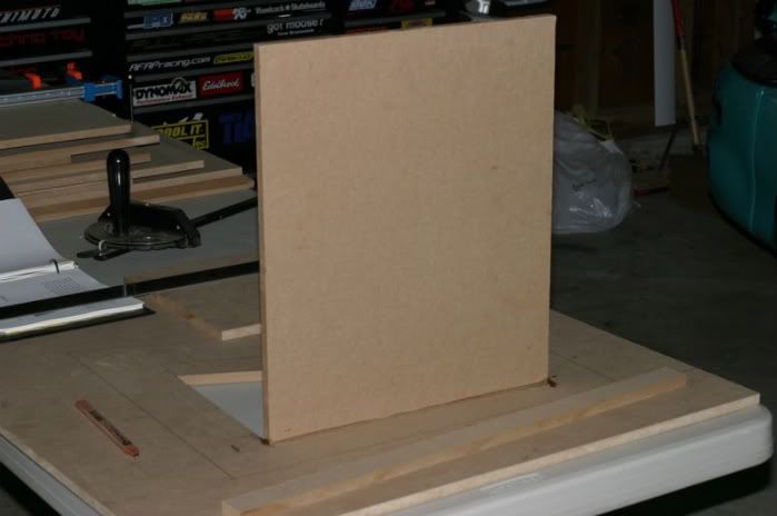

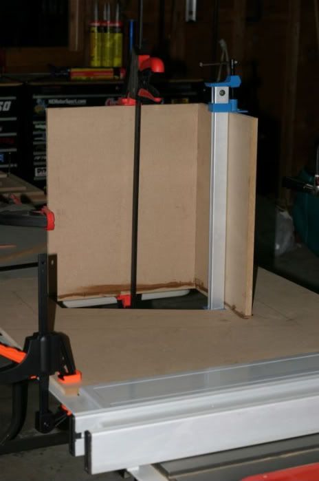

^^^ Thanks! everyone keeps saying it will weigh a ton, guess I'll get a second set of hands when moving it. Even if it didn't weigh that much, still a large box! :)

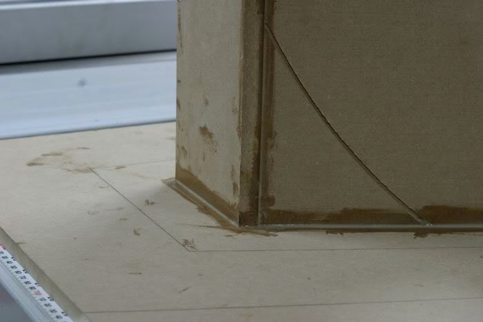

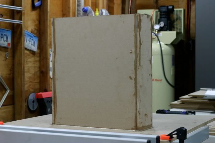

Alright, got a little more progress last night...

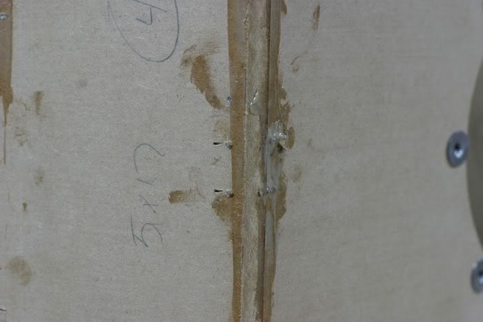

This is why I hate going on angles with the brad nailer... :o
Now I'm off to install panel 5 and 3/5 brace...!! The ONLY thing I'm not enjoying about the build is the PL, whoah is it messy :lol:

Looks good so far 8) ...I had the same issue with the brads 'cept I was using ACX, and they'd hit a knot or deflect off a ply, then blow out the side of the panel. Comes with the turf I guess.
Before you get any further, right now would be a good time to make sure that beautiful driver actually bolts up nicely to those H-nuts. If you already have checked for this, then disregard, but better to figure out now if there might be any issue than later. Dry fitting of parts in advance helps avoid nasty surprises.

Yeah, I fit the driver even BEFORE gluing anything at all. If it does fit, a new baffle is the solution, luckily, I've never had to replace one.
Sweet air compressor BTY... :mrgreen: drool
-Radian

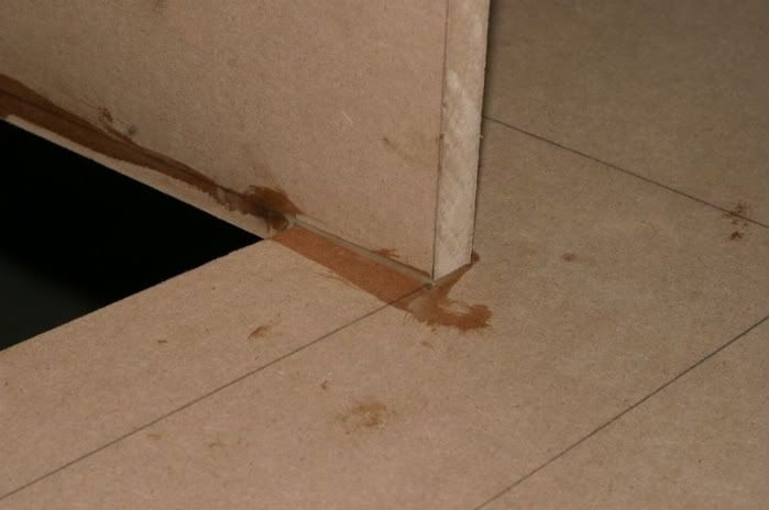

Lol, thanks for the props on the compressor Radian :D I did test fit the driver after installing 7 or the H-nuts. Why 7? because I forgot to drill out the 8th hole so I figured I'd get the 7 glued in, mount the driver and then mark where the 8th will go. Worked out fine, I think :fingers: I didn't test fit the driver in there after I installed the 8th H-nut, I'm sure it will be fine :)

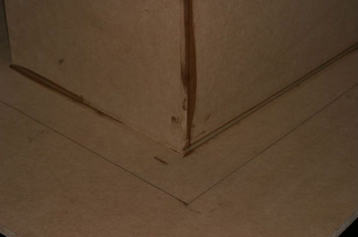

I just installed panel 5 and made the brace for 3/5. MY GOSH was the panel a pain. I cut my first one too short, dummy me, so I had to make a new one. The whole process took almost an hour and a half. For some reason, the panel wouldn't sit flat on the bottom board so there is a tiny gap, I will show in pictures tomorrow. I had to cut the angles many times and trim to fit a few times until I got it close enough. Then I applied PL, and brads, again, problems with the brads. I SUCK at nailing, ughhh, the 2nd worst part of the build, first the PL and then the brads. All of this hassle almost makes me NOT want to build my THTLP :wall:
