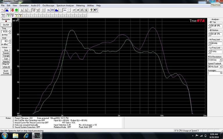

Purple (5) 1016 in straight array
Green (5) piezos on wooden horn
Goldwood 1016 Piezo response
bgavin
- Posts: 5738
Re: Goldwood 1016 Piezo response
I can't tell which is which.
If my eye are correct, I believe the straight array has the bump at 8.5k.
My eye tells me the same.guitarkeys.com wrote:If my eye are correct, I believe the straight array has the bump at 8.5k.
I can't tell the colors at all.
Mic calibration file is not used.
Unknown input voltage and measurement distance.
OP, please add some more info.
correctguitarkeys.com wrote:the straight array has the bump at 8.5k.
Jamie
- Posts: 29152
That response above 10kHz is way low, so something is off with your measurement protocols.
It's a Shure vocal mic (sm or pg 58), not calibrated. I measured a Eminence Delta Pro 8a in a small enclosure and it looks much like Eminence posted, all the way up to 5k. Although, the mic response posted by Shure is far from flat, especially above 2khz.
Anyway, I did the test because I was skeptical of the tweeters actually playing down to 2khz. They do! The wooden horn is to try to get the elements closer. They are 1 7/8" center-to-center and seem to couple better.
By ear, I feel the homemade horn sounds better and a little less harsh with some eq.
Sydney
Incorrect choice of mic for measurement - far from flat - it has a presence peakIt's a Shure vocal mic (sm or pg 58), not calibrated.
