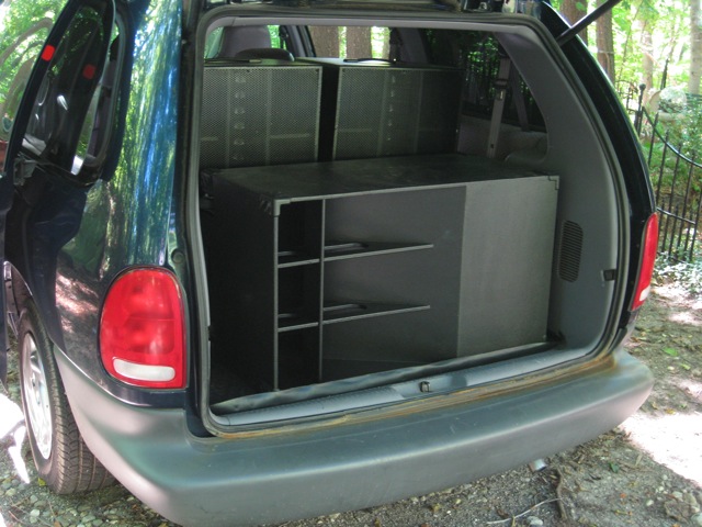

Loud and clear. That's what this system does. It makes every little thing obvious, including speaker placement and cancellations. The builds were slow, as I borrowed tools and help from family, friends and neighbors. The sound is awesome, during the latest tuning session I spent so much time just playing music because I was loving the sound. It reminds me of an large outdoor jazz festival I attended once, crisp and full. The dispersion on the DR200s is very wide, but there is a bright spot in dead-center where the melds meet. I'm surprised by how well the sound carries over a distance. There is absolutely no mud in this set-up.
Here are some videos I made of my setup, and a picture of how it fits in the old van. Of course the camera highlights the vocal range, drops the bass, and sounds hollow in general, but it gives you an idea of dispersion and volume. Using my Titan 39, I've always worried about reaching the max and blowing the speaker. Having measured it with a voltmeter, I am no longer worried about that. The output is incredible (did I mention clear?), and a single T39 is enough for my gigs. In these videos I'm running the subwoofer at 15db higher than the tops, through one side of a Crown XTi1000.

The system fits in the back of my van, with my rack and cable box fitting on top the Titan. The DR200s are on the folded bench seat.
