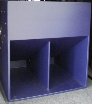

I have been working to optimize my car setup for dual AT's. I pretty much got the eq and crossover frequency set where I want it, now its just down to the amp. The AT's are loaded with high xmax dual 4 ohm coil drivers with 250w rms power handling. I got a MB Quart DSC 1000.1 to run the subs and the spec'd power is 350w@4 ohm, 500@2, and 1000@1. I have a deep cycle battery in my car and the amp is hooked up with 0 guage wire and a 10 farad cap. If I play a sine wave the amp sounds clean and seems to put out plenty of power but with music the results have been less than awesome. With dance music it sounds kind of lousy. Transients sound distorted even at lower levels. I played around with alot of settings and could not get what I want.
I said what the heck and pulled one my Bryston 4B's out of my HT stuck it in the car. The 4B is 250w@8 and 400w@4. Wham! There was the sound I want!!! I cranked it until the clip lights were just starting to come on and backed it down a hair. It sounded amazing no matter what kind of music I ran through it. I was measuring over 125 dB on kick drums from rock music. Dance tracks sounded perfect with lots of punch and deep bass to back it up. This setup yielded some of the best bass sound I have ever heard in my life.
So my question is what are the specs that make the Bryston so much better? It seems the power of the two amps is at least comparable so what should I be looking for in a 12v amp? The only thing I have seen that has similar specs to the Bryston is a Mcintosh car amp that costs lots of $$$. JL audio seems to have a few amps with good specs but most are class D and I haven't found many class D amps I like the sound of.
Per the AT plans a dual 4 ohm sub wired in parallel should be a 6 ohm load so two of those in parallel would be 3 ohms. Does anyone know of an amp that can do 500w@4 with the SQ to match?

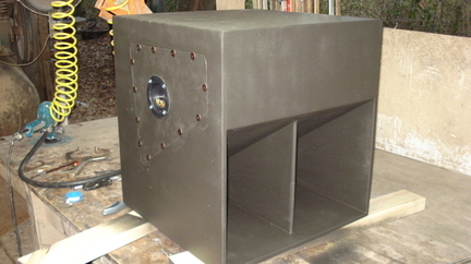

I have an alpine mrd-m300 mono amp for my TAT loaded with jbl 804 200w rms driver. The amp can put out roughly 100w (measured with 30hz sine wave) which seems good as it is rated at 100w rms at 4 ohms @ 12 volts and the nominal impendance of the TAT with a 4ohm driver is 8ohms (I am running the amp indoors with a modified pc power supply so its dead on 12 v sometimes dipping to 11v when turned up). Overall the amp does a very good job, i feel the TAT has got abit more in it but it gets really loud.

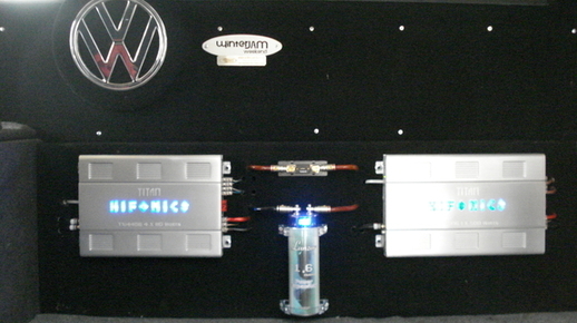

We've built several TAT19/10" (DCS255) and in our shop bus I've got a Hifonics Titan 500x1 on the TAT(1-2) and 100x4 midbass on up. Previous setup used 3 12" aperiodic. They were tight but the TATs detail and effortless quality is very impressive. I got my amps (factory refurb) for around 200 total..they have control everywhere you could want including variable subsonic HPass..

My AT's are loaded with Ascendent Audio Assassin 8's.
http://billfitzmaurice.info/forum/viewt ... =5&t=11511
