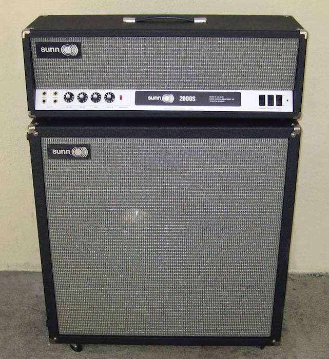

That logo looks very similar to the SUNN amp logo. Never seen that specific one before though.

It's a Mexican mark, probably copy from an even older one from USA, the fuse is 5 amp.
