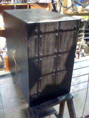

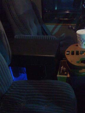

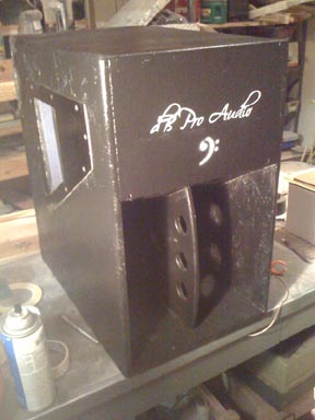

My amp came in today, so I got the TAT installed in my work van.
Had to build it 13" wide to fit between the seats. In hindsight, I think I could have gone 14" and squeezed it in there. Oh well.
Front

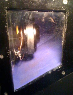

Driver Chamber
Back
Installed in the Van

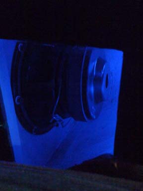

Closeup of driver chamber. Lit by 12 blue LEDs
So how does it sound?
I'm running 150 watts to it. Crossed over at about 60 hz. I'm not sure what slope the crossover is, but I'm betting it's only 6db. I just set it 'till it sounded right. The amp has a bass boost, but it is turned off. Bass setting on the head unit is at "0".
I made a mix CD of: Hip Hop, R&B, Jazz, Rap, Rock, Pop, Disco, etc...
Keeping in mind, it's a full size Van, so there is a lot of cabin space to fill.
On the Rap/Hip Hop/Techno stuff... I have to turn the bass down. Luckily, I got an amp with a remote. This thing puts out so much bass, I can barely hear the full range speakers. Plus, it makes my eyes go kinda blurry. Unbelievable !!!
On the rock, pop and disco stuff, the bass is very tight and punchy. It definitely hits you in the chest.
On the way home this evening, I took the long way so I could listen some more. :D
It's so smooth !!! Every note is defined. Not just boom, but actual notes. OF course, having used the T48's in a live band, I wasn't surprised by this fact.
I can't believe this much bass is coming from an 8" speaker. I showed it to a few people and they were extremely impressed. One of them kept asking where the other speakers were.
I've had several car audio systems over the years and I would compare the output to a couple of 10's with 1200 watts or so. However... the TAT sounds so much better that it really can't be compared.
Bill, you are truly an audio genius.
I can't wait to get started on the OT12's and T39's.
