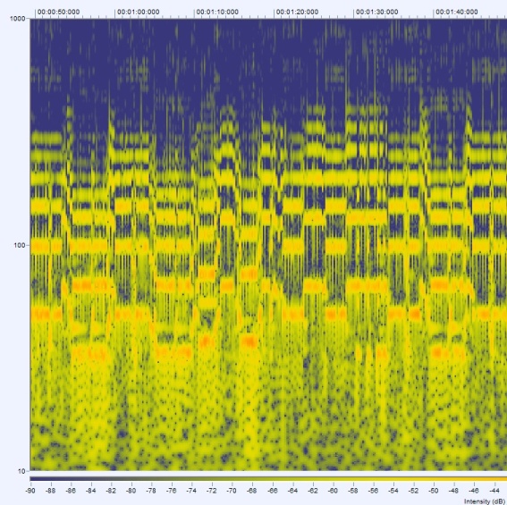

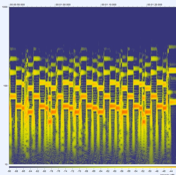

These are 'wavelet transforms' of 2 bass guitar tracks (solo). The horizontal line is TIME, the vertical FREQ, and the colors, INTENSITY. red being the strongest, blue the weakest, and yellow the middle. A full screenprint would have lost too much resolution.
The graph is limited to 10Hz - 1KHz. The lowest 'red' is the low B string (31Hz).
Clip1a = 5 string studio track that sounds deep, mellow, barely any highs or mids. You can see the 3 harmonics (1st harmonic = fundamental tone).
Clip2a = my 5 string bass, flat EQ, direct. 9 harmonics visible.
I don't know for certain if the Clip1a is direct or from a speaker. I know Clip2a is direct, no speaker.
I think that is correct, tdogg. * I mean an F# is ~23Hz...but I'd say you'd be hearing the 3rd harmonic (2nd overtone) @ ~69Hz, but feeling the 2nd harmonic @ 46Hz.*
*EDIT: F# = 23hz, not 16hz.
