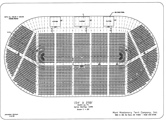

Hey guys it has been a few weeks since I last posted something. Here is the lay out of our facility and I needed help on the size of pa to use. The area is a covered by a tin roof and the floor is concrete with small areas that have a removable carpet .The back of the stage has a brick wall that is where the stage is. The area is 154' x 298' the seating is for 5990

What are you wanting to do? All voice, music, what? And how loud at the FOH? Is this a curtain sided tent, or no sides? This matters a lot.

Some elevation views would be helpful also

The building will have a steel roof and the sides will be canvas sides. We will be doing a mixture
of choir music and plays and speaking

Full band with the choir? Or just organ or piano?jesuchete wrote:The building will have a steel roof and the sides will be canvas sides. We will be doing a mixture

it is going to be a full choir and a band.
