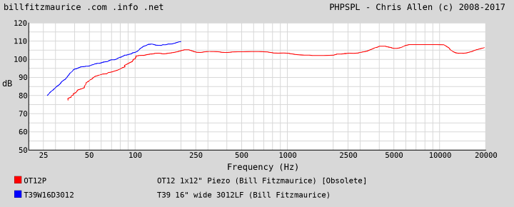

For EQing, try not to do too much EQing in the amp's processor - don't eq to taste, just EQ some of the idiosyncrasies of the cabinets out. Here's a chart of your two cabinets below:
(Note that the T39 is the wrong width, and the OT12 doesn't say which driver it's got... so these charts aren't perfect)
The first, most obvious correction you'll want to make is to EQ the T39 to tame some of that rising response out of it. If you set a PEQ at the PDF frequency with a fairly wide Q and bring it down 6db or so that should bring it back in line with the OT12s. (alternatively, you could just adjust the LPF downward a bit, say, to 110hz, and then set the PEQ to -3dB or so. It might actually sound better that way as you'll get less of the highs in the subs.) Other than that there's some adjustments to do to the OT12, especially in the high end, but in order to do that properly you'd really need a good graph of what -your- cabinets are doing. If your response chart looks anything like the above, a good starting point would be a PEQ at 8 khz with a medium width set to -3dB or so.
