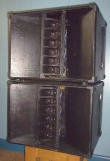

Last Friday I gigged the Jack10s for the 1st time.
Small room and inadequate space for the band. The two jacks were set up behind us and served as both FOH and monitors. 2 voices, an acousctic giutar and 6-string bass guitar through them.
There were quite a few musicians who came to hear the band. I received MANY inquiries from them about the cabs. (Because they look so unique without grills?)
One bass player was amazed at how good my bass sounded without subs.
Another musician compared them favorably to his $3,300 cabs. (He didn't mention the brand.)
No one could believe I only had $600 invested in the pair.
Everyone in the room, especially my band, thought they sounded great.
Needless to say, I spent a lot of time during breaks writing down "Billfitzmaurice.com" for people!
Here's the pic I promised of the completed cabs:
