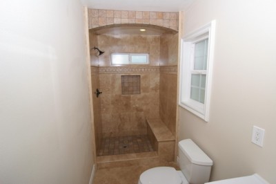

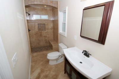

when i do remodels on baths i strip everything down to bare studs and then hot mop the shower pan area, my tile guy floats spec mix to get the slope then tiles over it, best way to do it, no seams to leak in the future, any other type of liner will have seems for potential leaks except a one pc. pan, here are pics of one of the last ones done, the bench seat and about 12" up from the floor were covered in thick roofing felt and hot mopped with molten tar, why dry it is leak tested for 24 to 48 hours and then the tile guy waterproofs the the rest of the walls with roofing felt, then puts up wire and floats the wall plumb with spec mix (cement) then tiles
