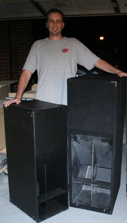

ImageA 16" T39 next to a (photoshopped by Sydney) slim T48 (after Bruce commented on it being an oft overlooked box)
but nobody gave dimensions!!
