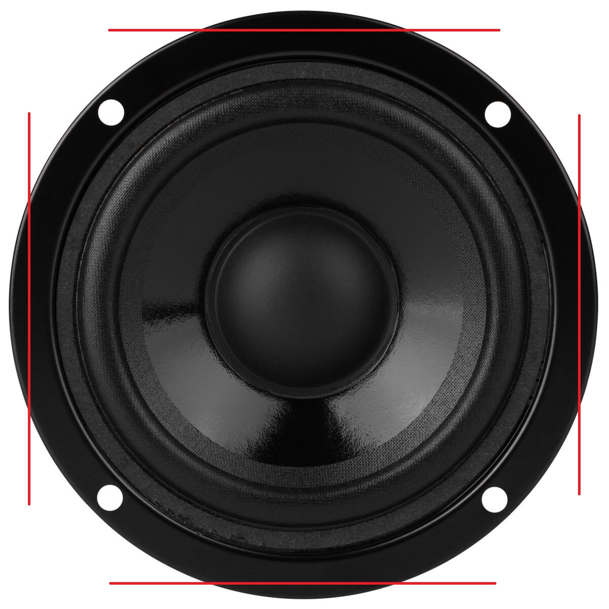

At $4.90 each, I've been considering these.

Those look very good, and the price is right. I'd scoop those up if I was considering a build.

That's a good point Bruce, for a 4 driver SLA. Works out fine for an 8 driver center or TLAH. Not sure I'd be too-too worried about a 4ohm main. It is a valid point and consideration.
The slight hitch I saw was that their edge to edge diameter is 4.75" and the plans specify not more than 4.5" edge to edge.

Bill, in looking at the Sketchup files, it looks as though those drivers 4¾" overall diameter could work okay for the SLA center with tweeters rear mounted, would probably work okay in a TLAH with 8 drivers, but the height of the SLA's wouldn't accommodate them without modifying the cab dimensions or trimming an eighth off the edges of the driver. Neither of those options seems like a deal breaker, I wouldn't think.
Would you recommend either of those options in particular over the other, or just suggest looking for a different driver of the correct dimensions?

I built my SLA's with 5" drivers similar in style and price to Seth's link. I didn't need to modify the crossovers, but I did have to redesign the cabs (which was against the plans). It was a total pain in the butt and I'll never do it again. At the time I was working with an extremely tight budget. My advice it to use the recommend parts or find some with the same specs as to not alter the plans any.

Making the box large enough to accommodate 4 3/4" diameter drivers is no biggy, since it's a sealed cab and you don't have to be concerned with upsetting the tuning. OTOH looking at the backside of those drivers I can see that it wouldn't be difficult to trim them with an abrasive blade, just being careful to wrap the motor well to keep metal sawdust off the magnet. I'd even use tin snips if using a grille.
