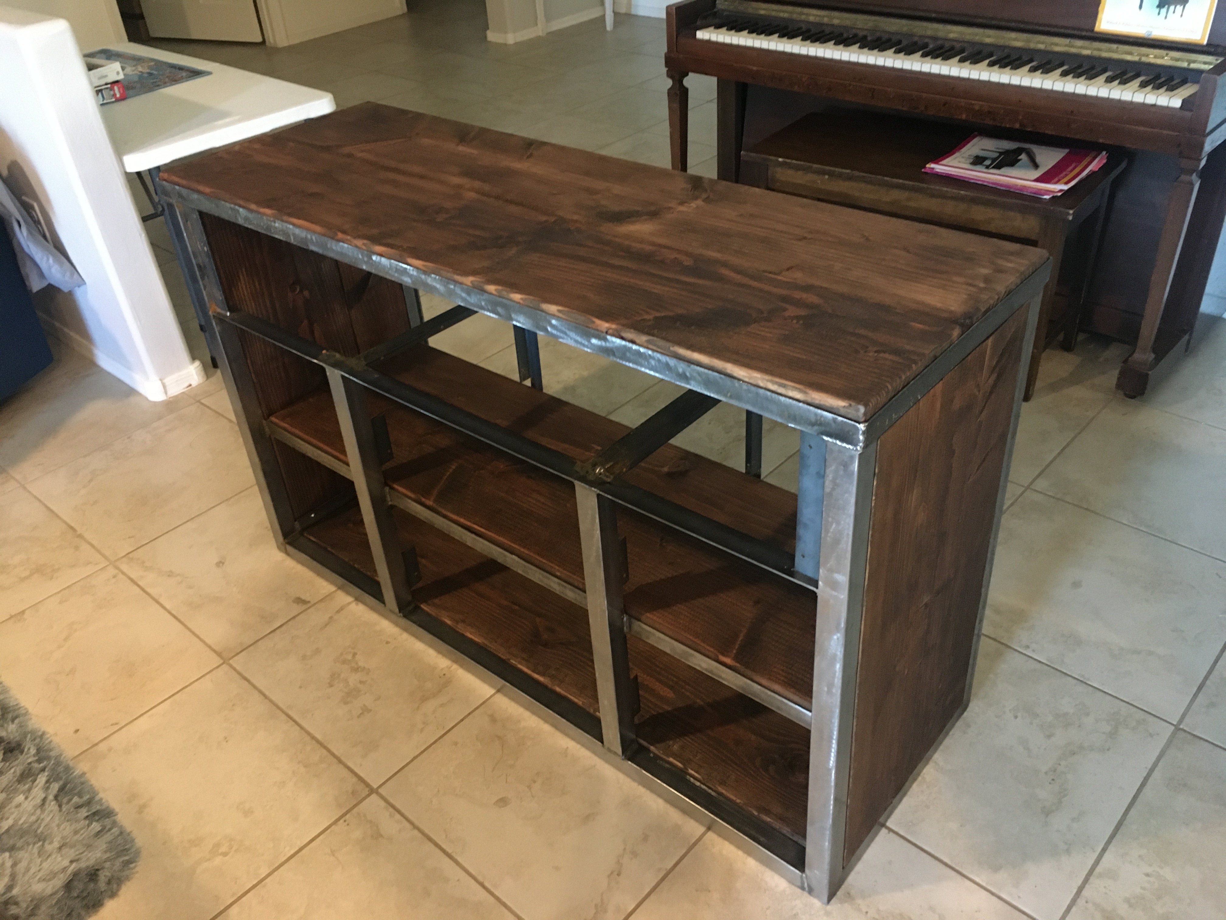

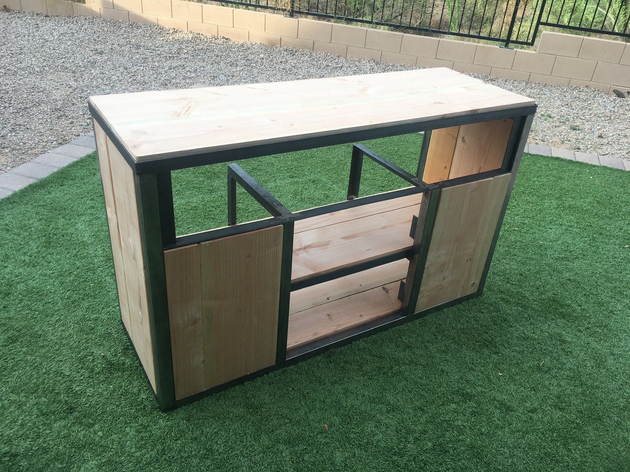

Hello everyone, I have started the ground work on building an entertainment center and home theater sound system. The attached picture is the center piece which the tv will sit on and there will be built into it a 9 driver horizontal sla cabinet. I will be building two book shelf pieces to sit either side of the center piece and they will house a Tlah each. The bottom of one of them will conceal a table tuba behind some dummy doors.

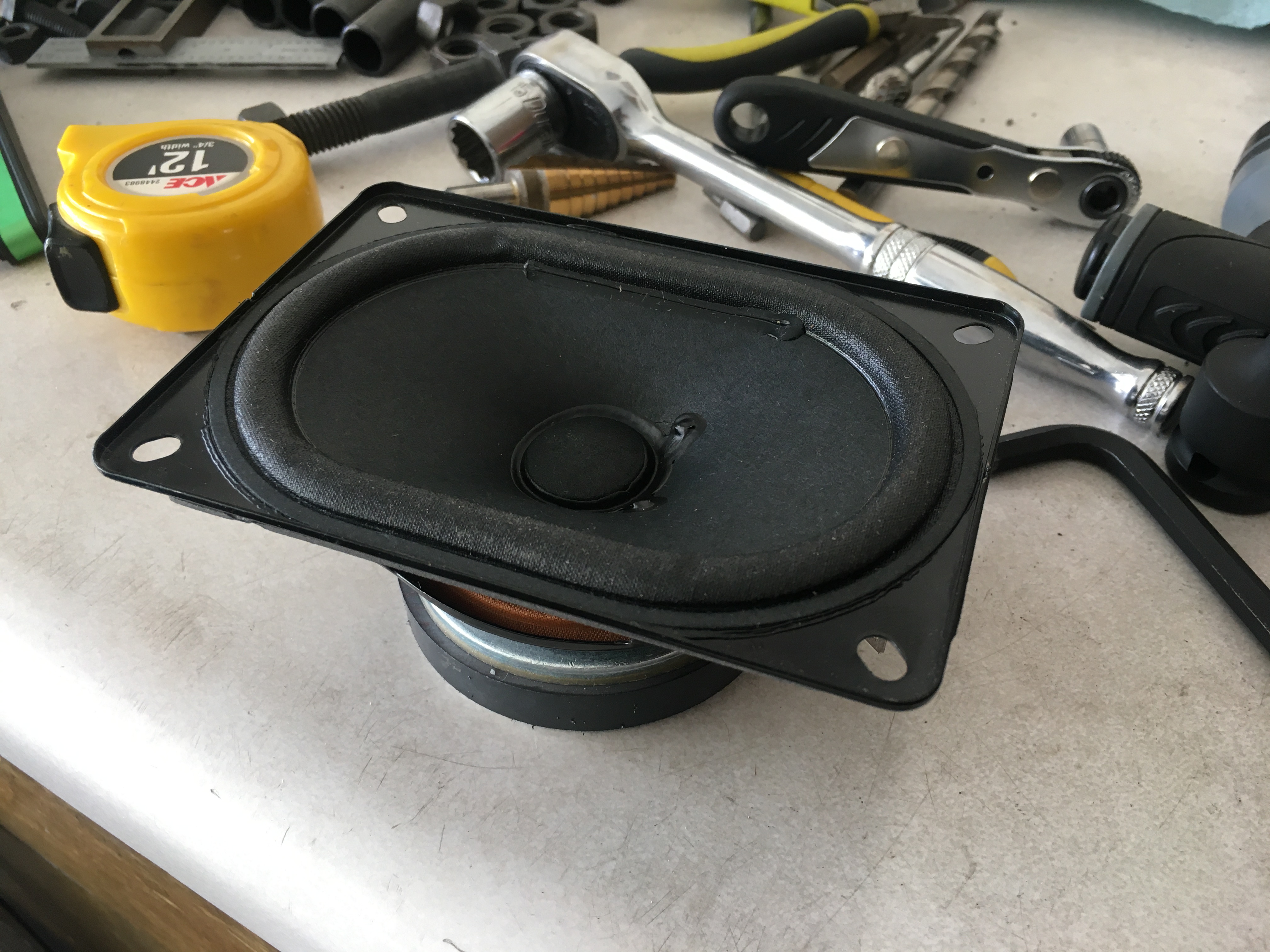

Radian just sold me a dusty box full of the old JVC 3x5 buyouts that he had been sitting on. I was told that several people here had purchased and used them a few years ago now. I tried to search "JVC 3x5" and I located a few threads dating back about the 2011 range. I find no pictures of builds with these drivers. Radian assured me that these drivers are a good match spec wise for the Tlah/SLA cabinets, I have plenty of reasons to believe him.
I am happy to use these components and for what I paid it is definitely worth the attempt.

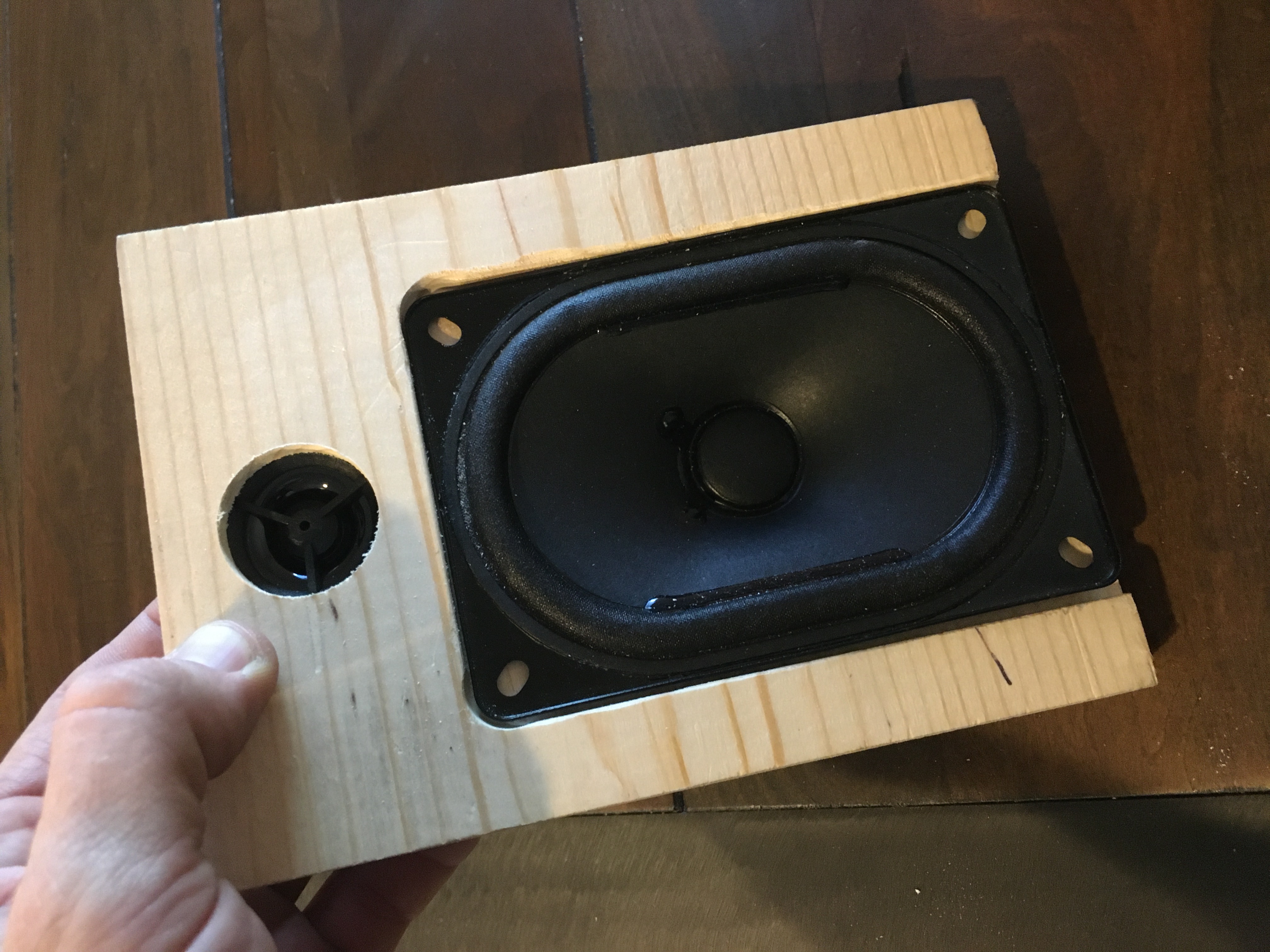

My first question now is how do I orient the rectangular framed speakers? For the TLAH cabinet at 40in high, only 8 may fit if I install them long side vertically. To me this orientation is correct in adherence to the line array method, but it seems like I read that 9 drivers is possible which indicating a long side horizontal orientation. Can I get clarification on this?
Second question is related to the horizontal curved SLA cabinet and the rectangular driver. How should I orient the drivers for that design? I am inclined to say long side vertically oriented is going to be correct but I have no idea why I think that. I hope to get clarification on this as well.
The tweeters I picked up from Radian are 4ohm, I will have to glue them to the cabinet from the inside by the looks of it. As I understand they were a cheap buyout that existed during the same time that the JVC 3x5 drivers did.

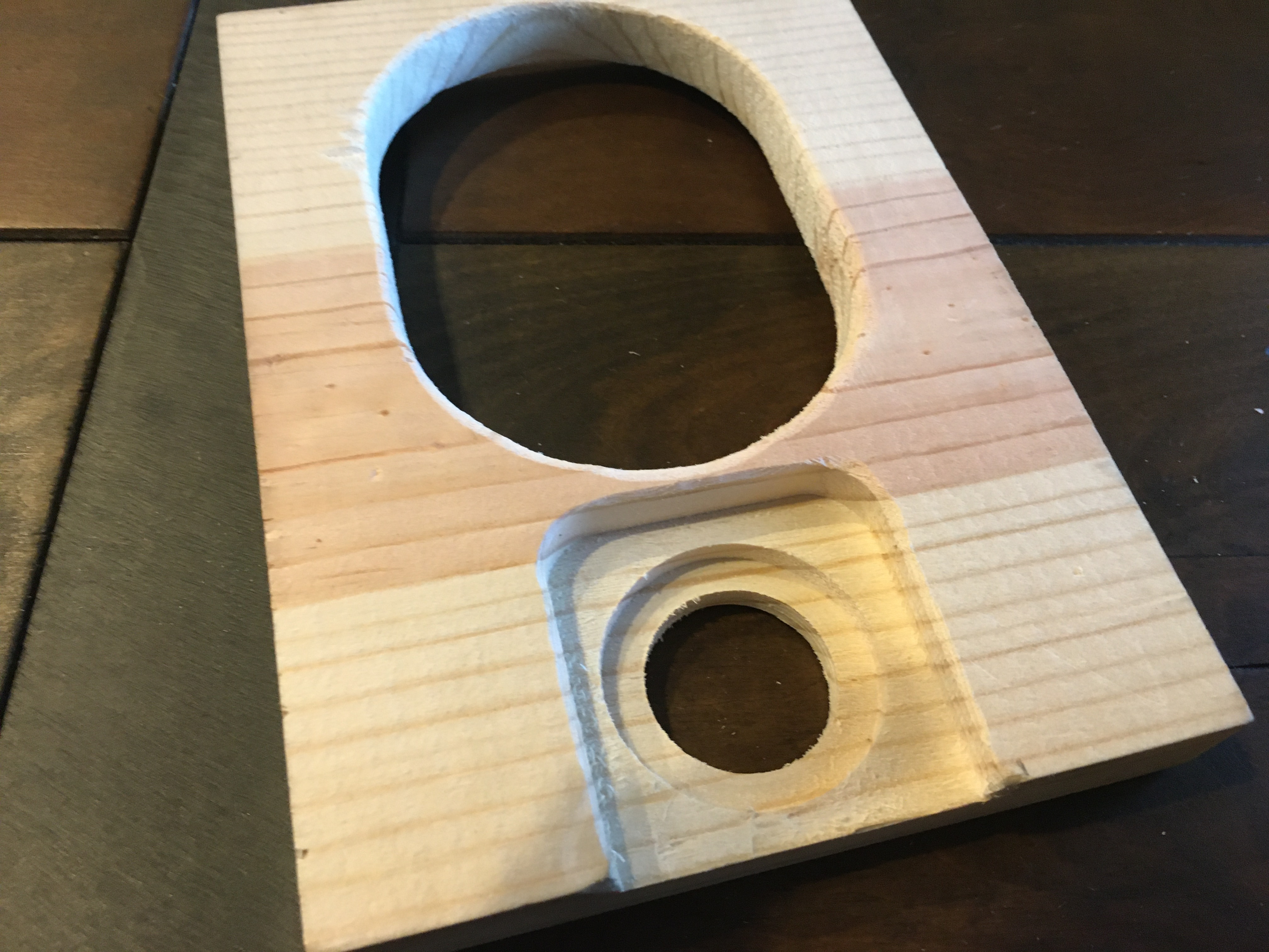

Attached is a pic of the drivers I picked up. They measure exactly 4 7/8” long ways, I will make them work. Is that vertical recommendation for both cabinet designs?
Posts: 28978
Re: Building my home theater rig, Tlah, Table Tuba
#9 Post by Bill Fitzmaurice »
Yep, vertical in both.

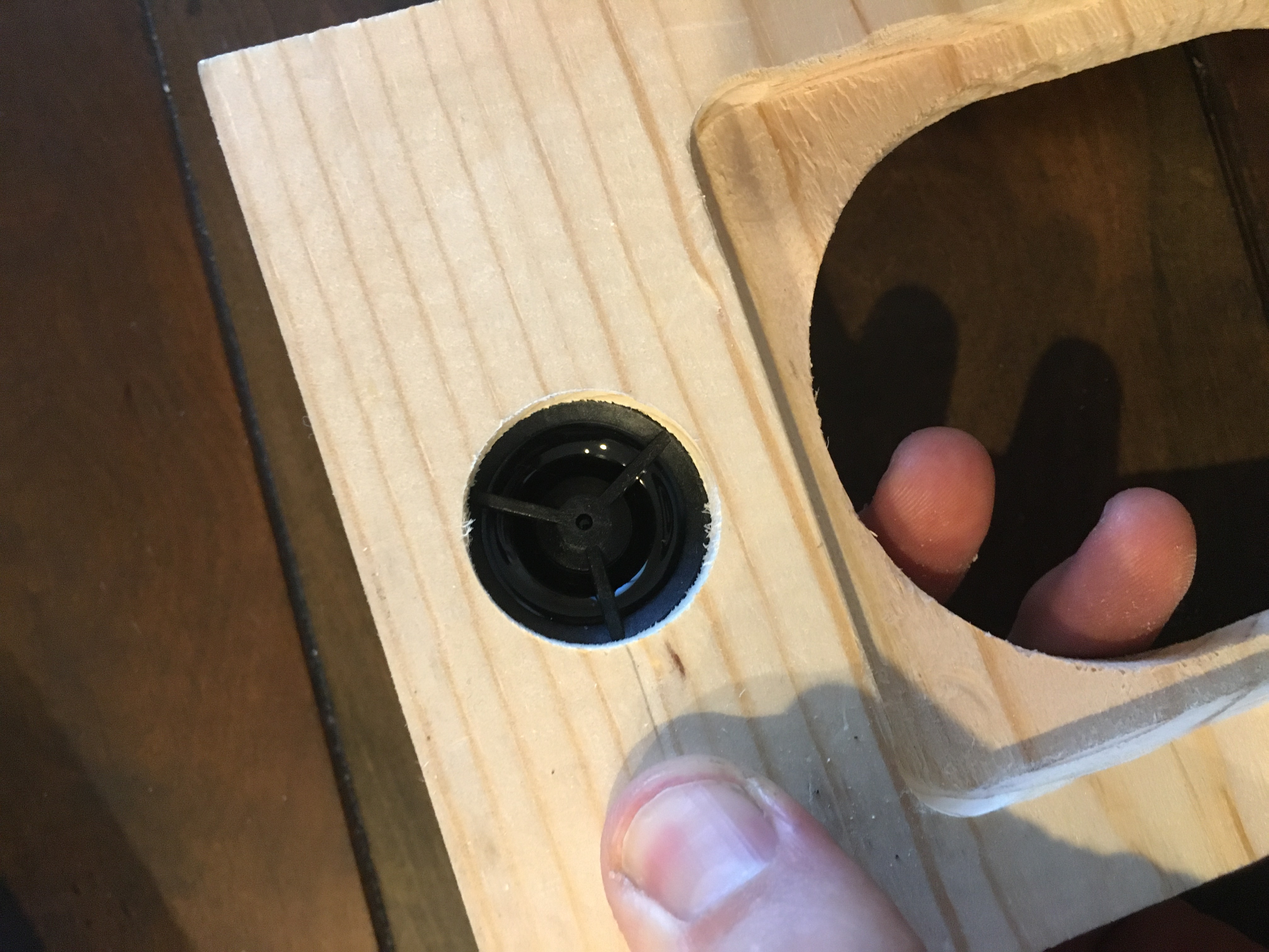

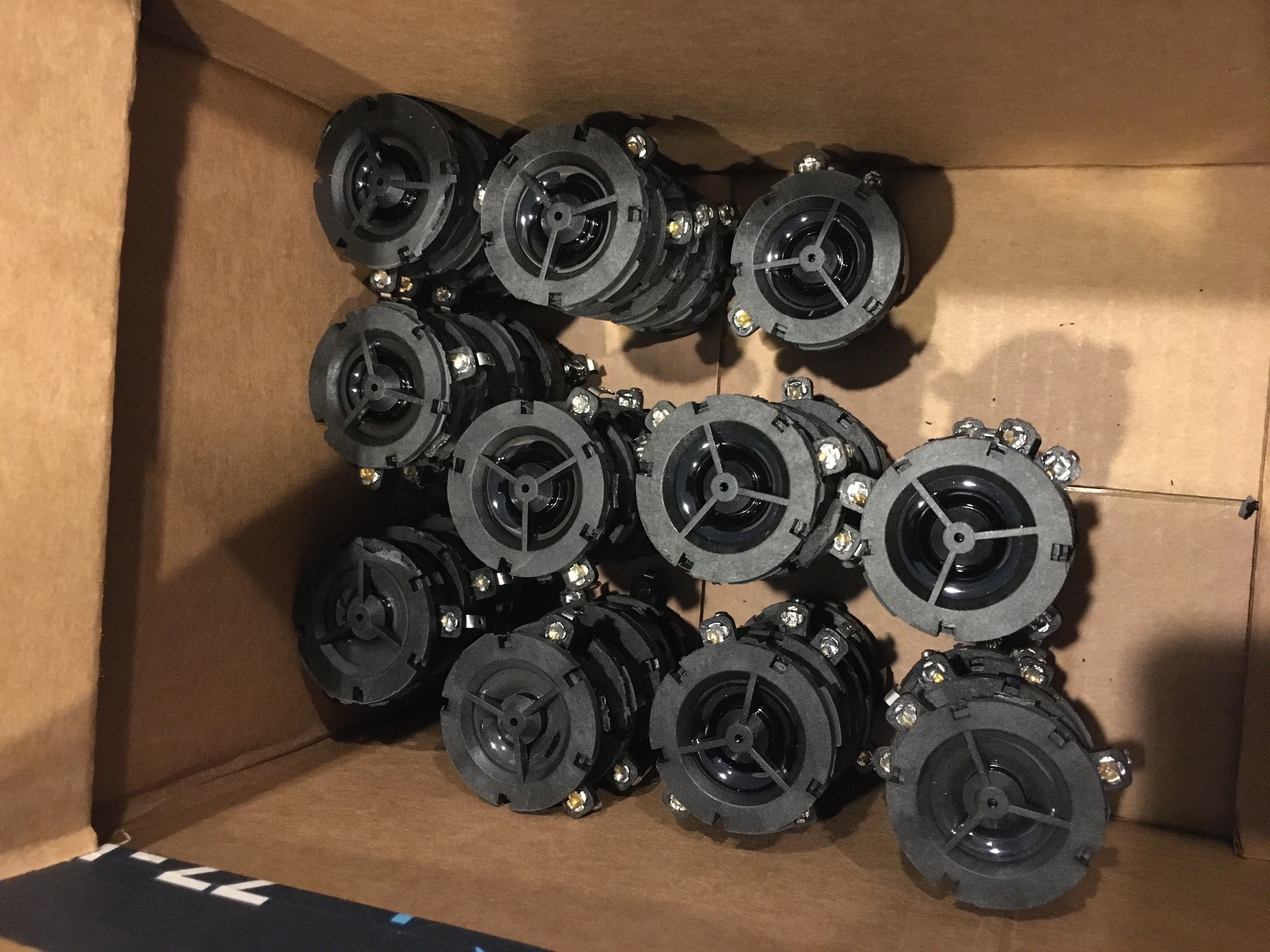

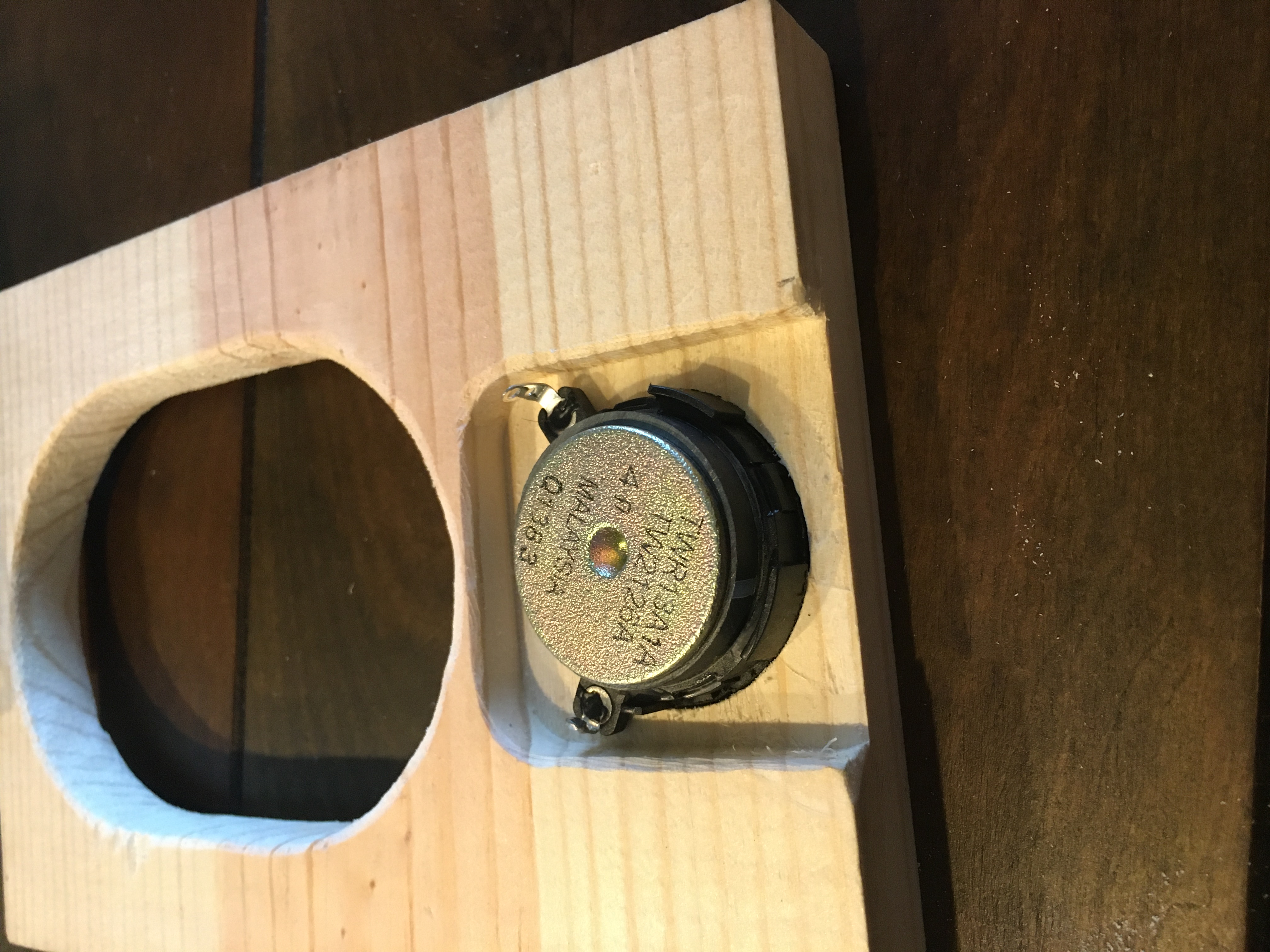

Attached pic of the tweeters that Radian supplied me with. I do not know much about them except that they were a buyout and they are 4ohm rated. This poses a bit of a challenge as the plans call for 8ohm high frequency drivers.
I turned down the mounting surface of these tweeters for easier use. I will be rear mount/gluing them to the cabinets where the mid woofer will be front mounted.
Posts: 28978
Those are the same tweeters I used in my CurveArray, glued to the inside of the baffle. Using eight of them you can wire four in series to get 16 ohms, two banks wired parallel to get a total 8 ohm load.

Progress update, started staining the wood. Using provincial color stain. I really like the color. Price of plywood has gone down some but I still struggle to afford it, as soon as I can I will get to work on the speakers.
Provincial color wood stain for a warm rustic look

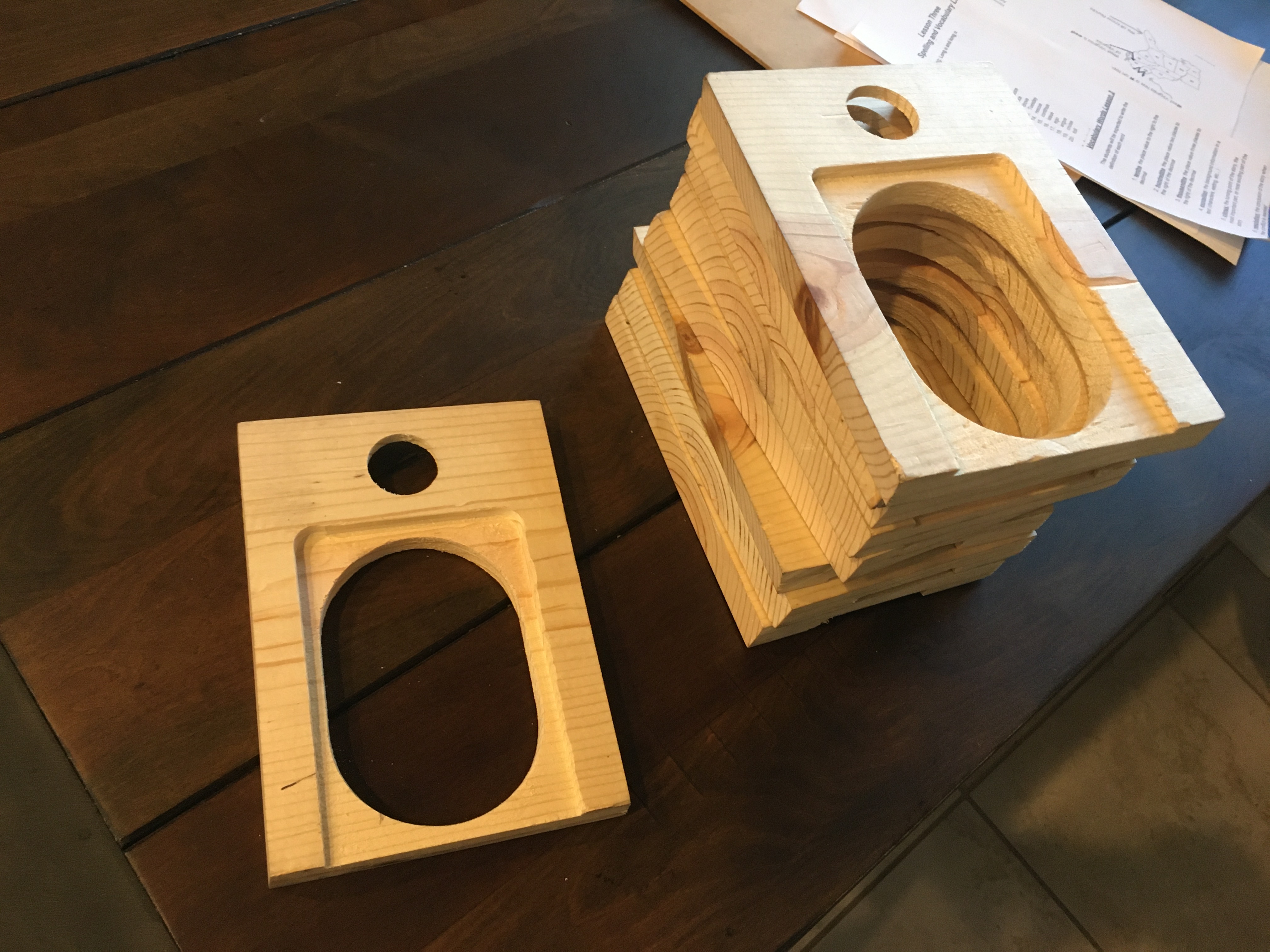

Cut out and router worked the baffles to the curved SLA cab, this to be my center channel. I think so far so good I will be ordering the filter components in a few days if things go my way. This is turning into a build thread.
