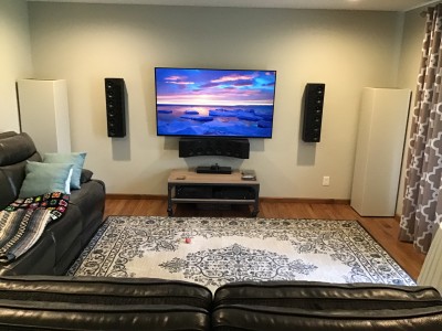

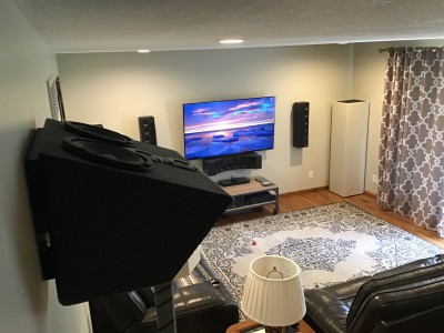

Hello, I am currently using two SLAs for my TV which plays movies, TV shows, and music. They sounds great....but would the TLAHs sound better? I'm ~12-13' from speaker to listening position and the room is 33' front to back. Or should I stick with the SLAs and build a center speaker? Finally, can SLAs go on the wall like TLAHs can? It would help my WAF situation. Thanks!

Unless your goal is to build the ultimate home theater, I'd stick with the SLA and build the center and surrounds. The angled TLAH would be nice hung up in the corners, but as far as sound I don't think you'll ever max out your SLA's and still stay married. I just don't see it worth building new cabs. Someone prove me wrong!
Also, what do you have for the low-end?

If your bottom end is covered appropriately, I can't see a TLAH being worth the trouble being as you already have SLA's.
You can easily wall mount the SLA's. Google "French Cleat"
What configuration are your SLA's?

Build a center and surrounds. There's no reason why you can't wall hand SLA.

And we have the two slas and the sub right now. The sla center would be pretty fun to build….that and stick the R and L speakers on the wall and we’d be set. Even if a compelling argument is presented for the tlah….the center channel should probably come first. Thanks!

SLA mains, center channel and surrounds all hung on French cleats. Dual Table Tubas long style sitting vertical for the low end.

Hey Dale, are your surrounds built per the plans? My copy shows them firing straight up at the ceiling.

My own take, two mid bass and two tweeters. I have 8 foot ceilings, so good dispersion mounted about a foot down. They sound great.Hey Dale, are your surrounds built per the plans? My copy shows them firing straight up at the ceiling.
