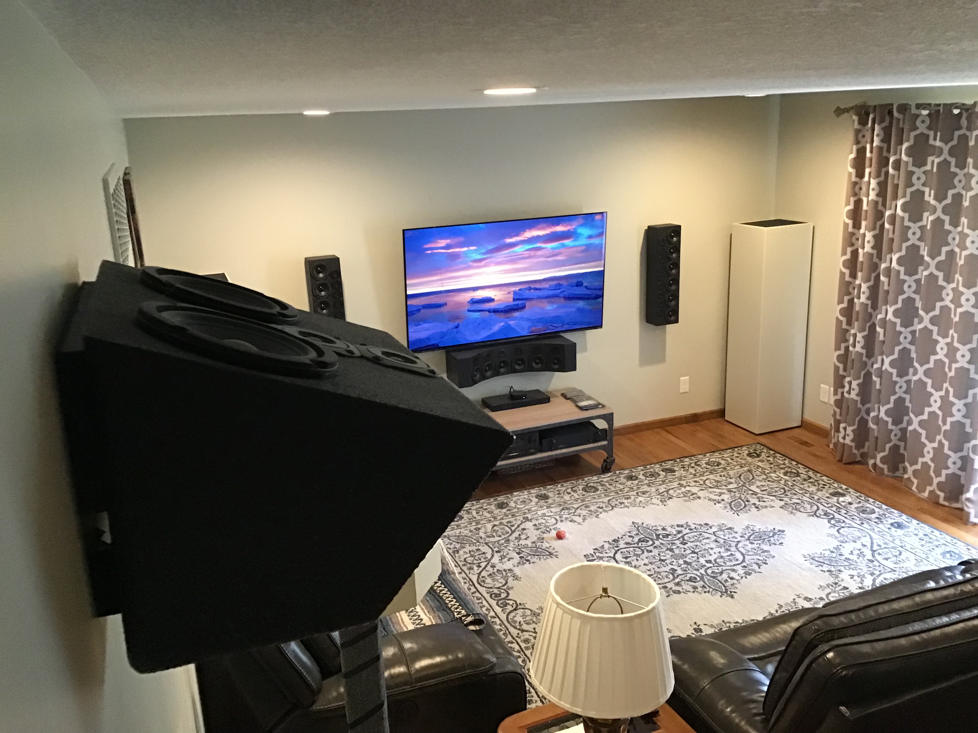

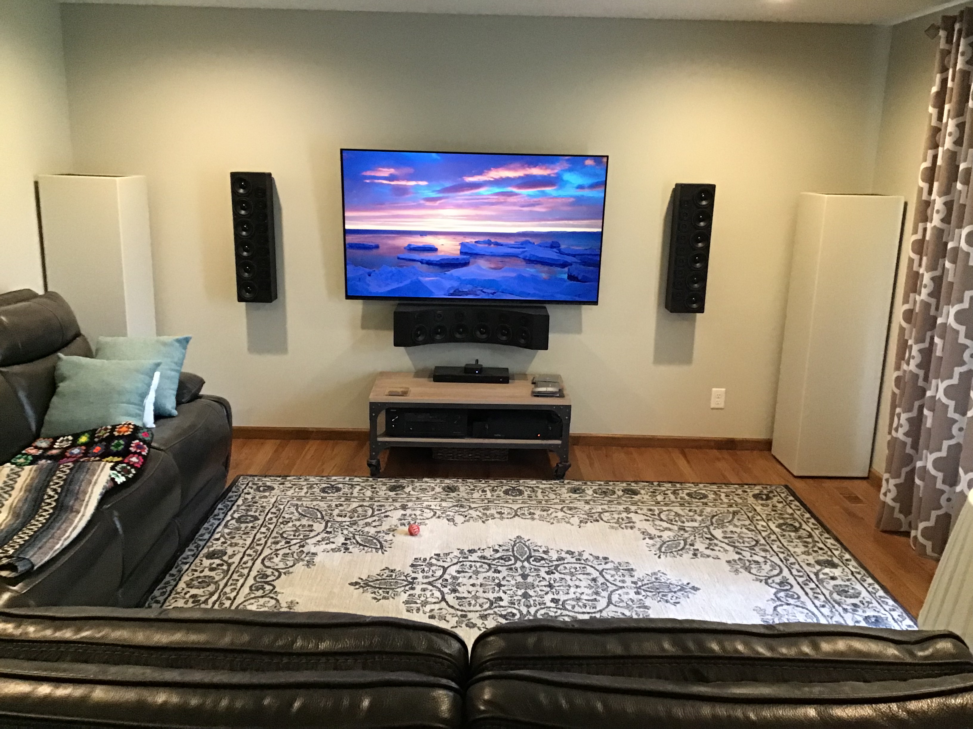

SLA mains, center channel and surrounds all hung on French cleats. Dual Table Tubas long style sitting vertical for the low end.

Hey Dale, are your surrounds built per the plans? My copy shows them firing straight up at the ceiling.
My own take, two mid bass and two tweeters. I have 8 foot ceilings, so good dispersion mounted about a foot down. They sound great.

Dale Hammer wrote: Fri Dec 03, 2021 2:02 pm SLA mains, center channel and surrounds all hung on French cleats. Dual Table Tubas long style sitting vertical for the low end.
That’s great! I’ll give it a shot!
Are the vertical table tubas in the table tuba plans or are those something you came up with yourself?

From the info/sales page
Measuring 15 inches high and 60 inches long, use the Long Style version if the WAF dictates a rectangular shape. Or stand it on end next to the wall or in a corner when floor space is at a premium. Or toss some cushions on it and use it as a combination sub and couch. It's the same TT sound, only the shape has changed.
Also
The Table Tuba, Table Tuba Long Style, Small Table Tuba and Small Table Tuba Long Style are separate plans. You must specify the exact version you want when ordering.
