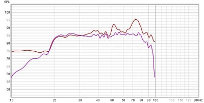

#4 Post by wuzzzer »
I have 15s in my 24x36x36 THTs in a huge open basement. Here's my before and after sweeps in REW:
Klipsch + dual THTs= :shock:
wuzzzer
Posts: 8
Joined: Sun Oct 24, 2021 12:03 pm
Re: Age old question: 15" or 12" for THT?
#5 Post by wuzzzer »
The reddish line was the initial sweep, the purplish line was after mild EQ and adding a steep 16Hz high pass filter. These things are absolutely nuts.

wuzzzer wrote: Wed Apr 20, 2022 10:05 pm I have 15s in my 24x36x36 THTs in a huge open basement. Here's my before and after sweeps in REW:
That purple line looks reeaaallll nice. The T39's I've been using are nearly flat down to 30hz, but they drop like a rock below that. I can get my Table Tuba down in the low 20's, but it's just not very loud when it gets that low.
24" wide is likely what I'll go with, but I need to measure my space and make sure it's a good fit. The Dayton Ultimax's are the same price as the RSS390 HF-4, so I'll probably just go with the Ultimax even though it's overkill. If only the price of plywood would come down.

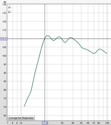

Posts: 140
Joined: Sun Feb 28, 2021 6:43 am
#7 Post by JensToft91 »
Shawn. I have 20 Hz extension on my 12" thtlp aswell. Minimum width.
With my tiny 50w board amp, I can sweep about 110 dB at 20 Hz.
JensToft91
Posts: 140
#8 Post by JensToft91 »
Response is with audyssey dynamic EQ and minidsp correction, hence the falling response. (Dynamic EQ boost lows)

JensToft91 wrote: Mon May 09, 2022 3:15 am Shawn. I have 20 Hz extension on my 12" thtlp aswell. Minimum width.
Oh nice, that looks great. I haven't purchased anything yet because I haven't had much free time (my kids play baseball and soccer). I was kind of set on going 15", but your graph is making me question that.
