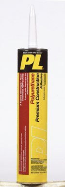

My area seems to have run out of the PL I'm used to using:
This is all I could find locally the other day:
Any difference? New label? Let me know what's up after a frustrating shopping experience. Thanks,

Pretty much answered my own question after some more research - new label, same stuff. There's an 8X version that appears to have a little grit to it and is thicker with more ooze out and harder to work with. If anyone can add to this it might be helpful. thanks,

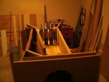

Thanks guys: I was faced with the same problem when I went to get more.
I even bought two more types of "PL", a water-clean up type, and what appears to be "the original"
All three types seem to work equally well for sticking things together and plugging leaks.
I bypassed the ~ $8/tube "8X-stronger". Amusingly, the price seems to scale with the "X-factor" on the tubes :P
Any other experiences with the water clean up type, which is much easier to use, but
cannot stick together previously finished surfaces? (Note on tube)
This should only be a problem when repurposing previously finished as I did in my construction.
You can see a scrap used as a brace painted red, to the left of the PL tubes.
My guess is that the solvent in the non-water based PL penetrates most finishes
