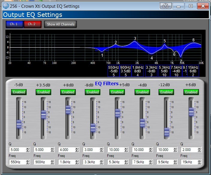

The weather finally decided to cooperate tonight. It has rained everyday, even today. It started to clear out so I setup my gear outside for an RTA session. I used an XTi1000 hooked up to a laptop with System Architect 3. I used True RTA to do the testing. I do have a Driverack PA+ but I have not played with the RTA on it yet so I stuck with what was familiar, the sky still looked threatening
I tested all 4 speakers individually and stacked in pairs just to be sure and I got consistent results. After I was done I took the speakers to my work room for a serious listening test. My work room right now is an unfinished bedroom. The walls and ceiling have exposed insulation and are fairly flat, there are no echos. I repeated the RTA test at 5' and the results were virtually identical to the outside measurements with the speakers on a pole and the mic 15' away.
So at this point you may be wondering how they sound. Before I set the EQ I was not overly impressed with the sound (I wasn't happy with the DR250's either before EQing). After the EQ they are very smooth and sound like a good set of home speakers. I am very impressed with them now that they are dialed in. If you have DR's and have not taken the time to EQ your system you are missing out on what these speakers can really do! The resulting EQ curve would have been very difficult to come up with by ear alone. Measuring equipment is a valuable aid and there is no excuse for not doing it when there is even free software available.
I have attached the XTi settings that I came up with. The 9.5K band is set to -12, it can't be completely seen in the pic. I am not sure if these settings will be of use to anyone since I used a different woofer. Everything above the 2k xover point should still be useful.
Last week I bought a pair od Delta Pros to finish my 3rd pair of DR's but I like the sound of the B&C woofers so much that I think I will get 2 more so that all 6 DR's will have the same driver. The Delta Pros will go in some wedgehorns.
Edit: Updated file with easy to read dB settings
